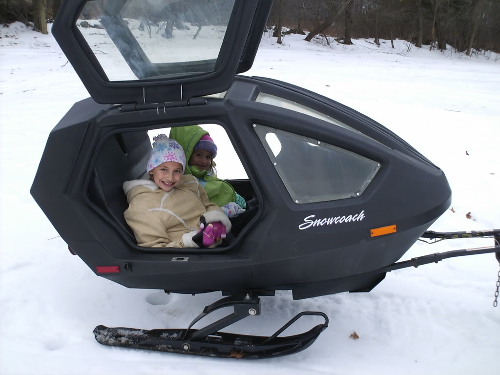

  10. Kingfish
    Kingfish Self Reliant
    I see it all on the lake every winter. Love the little tow behind sled for the kiddes.
