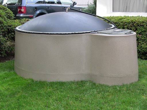

    There are commercial products to make bio-gas... Here are a couple of example types - expanding and fixed.
    Most neighbors in an Urban area would
    1) Freak out
    2) call Code enforcement
    or
    3) Sue you for maintaining a nuance - esp if there were a leak (odor)
    BTW Paul - auto gas here in Anchorage is at least as expensive as in your area....
    Asia-Off-Grid likes this.

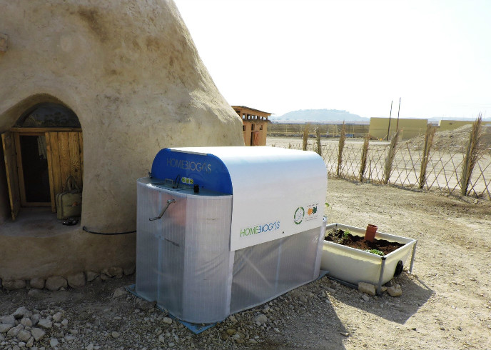

    Some more commercial products - this time, world wide
    Backyard unit eats trash to make biofuel Israeli, of course)

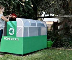

    unknown vendor, but this a nicely done 'Home sized' unit....
    Much past these and you get into what I would call 'industrial' systems that require a lot of space and have dedicated, trained staff - even if part time.
