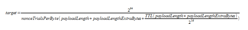

    Proof of Work
    Generally the POW is done exactly like in version 2
    The "target" (the difficulty of the POW) is defined a little bit lower (more difficult) in version 3. This is, because practice did show, it is to easy to flood the network with data. In addition to that it is possible in version 3 to lower the time to live of a message (for example when doing a live chat) and getting an easier POW for that.
    payloadLengthExtraBytes = 1000
    nonceTrialsPerByte = 1000
