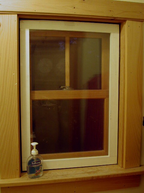

  12. Ganado
  13. chelloveck
    chelloveck **BANNED**
    It looks interesting, Ganado, and although it would probably help reduce heating costs in winter; being a film that is vulnerable to sharp objects*, it would seem not to offer much by way of blast or ballistic protection.:(
  14. Ganado
    well i was thinking more along the lines of make blast prrof window inserts but now sure how you would secure them from inside.
  15. chelloveck
    Concrete in place. ;)
