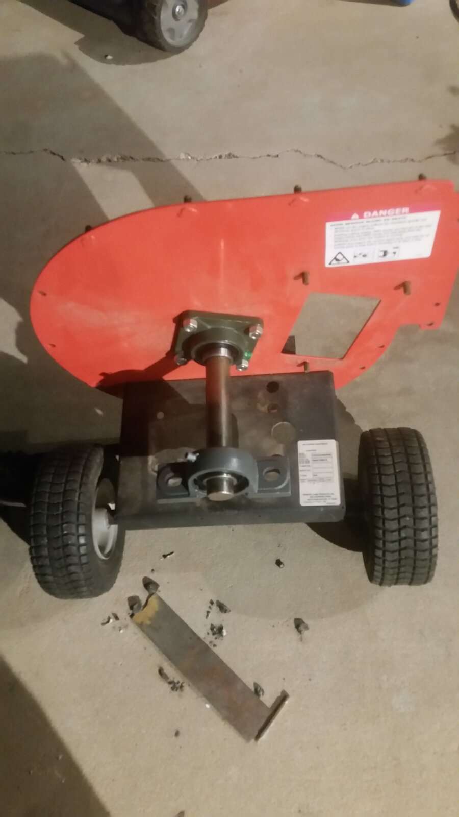

  19. oil pan 4
    Well I killed my wood chipper engine.
    Broke the flywheel off the crank shaft.
    So now it will be remade. I have the technology. But it will cost, a few hundred dollars.
    It will be belt driven that way I don't kill another engine.
  20. oil pan 4
    I removed the busted engine.
    I'll salvage parts like muffler, air cleaner, carb, gas tank.
    I'm replacing the engine with a 1.25 inch 4310 steel shaft and bearing bridge with 1.25 inch flange bearing and pillow block.
    I think it looks a little ridiculous, it's past overkill, it's more like ultrakill.
    20230407_205751.
