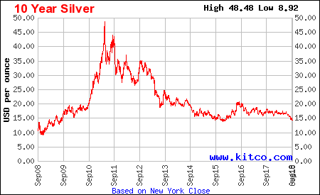

    Silver spot is below $14 an ounce for the first time in a long time.
    Probably about a 9 year low.

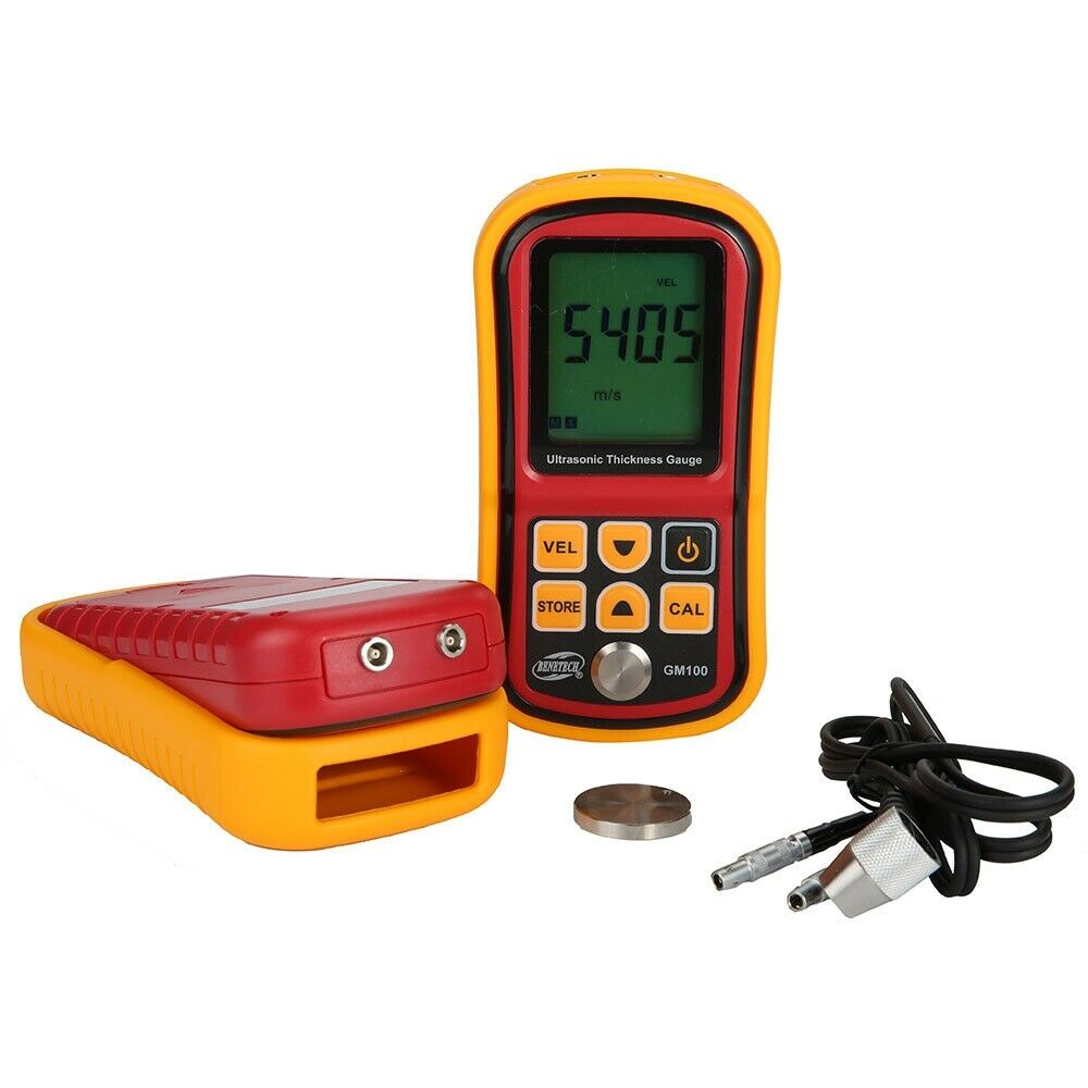

    I use one of these and a scale that reads in 5 decm's

    Ultrasound is good it will detect chunky non homogeneous stuff inside your gold.
    Asshats like to drill out gold and replace it with tungsten rods. As tungsten is about 99% the density of gold and you're not going to catch it by density check.
