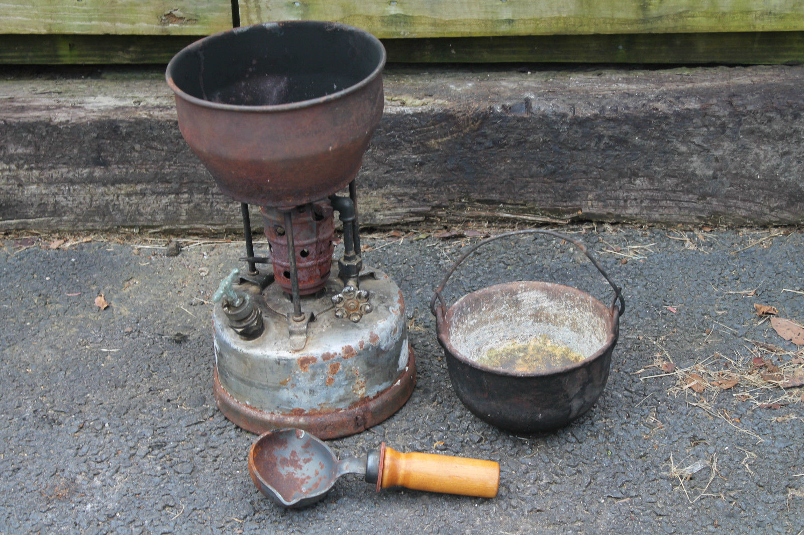

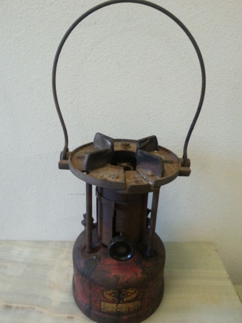

    I've never seen this type of pot, Anyone know anything about it or perhaps a link? Thanks
  7. HK_User
    Looks like a typical "Plumbers Pot". Sewer pipes, cast iron as well as ceramic were sealed with tarred jute and then hot lead. Some homes had soft lead kitchen and bathroom drain pipes that were soldered together using this heater or a blow torch as a heat source for the soldering iron.
    Vintage Plumbers Furnace Burner UNIIQUE MFG.Co No 50 Gasoline Melting Pot
    was used to heat the lead with that style pot
  8. Gator 45/70
    That's an old furnace, 30's ?
  9. HK_User
    New enough that it did not burn leaded fuel.

  14. kellory
    IMG_20150219_211526581.
    Soak it. Mine is coming out nicely.:)
  15. HK_User
    It's just an old pot, heat it up and the rust will go away.
  16. Gator 45/70
    For Real !
    Hey Kellory, I use the bottom spoon for removing the dross from the top and also stirring the pot, Locally this is know as the Groout, You can make your own with a grinder. roux spoon.
    kellory likes this.
  17. Gator 45/70
    Lol, What he says is true, Rust floats to the top.
  18. kellory
    Did it start out life as a tea spoon, a table spoon, or a serving spoon?
  19. Gator 45/70
    That baby is about 15'' long, Know locally as a roux spoon, Distance is your friend in this case.
    kellory likes this.
  20. Gator 45/70
    You Sir are wise beyond your years!
