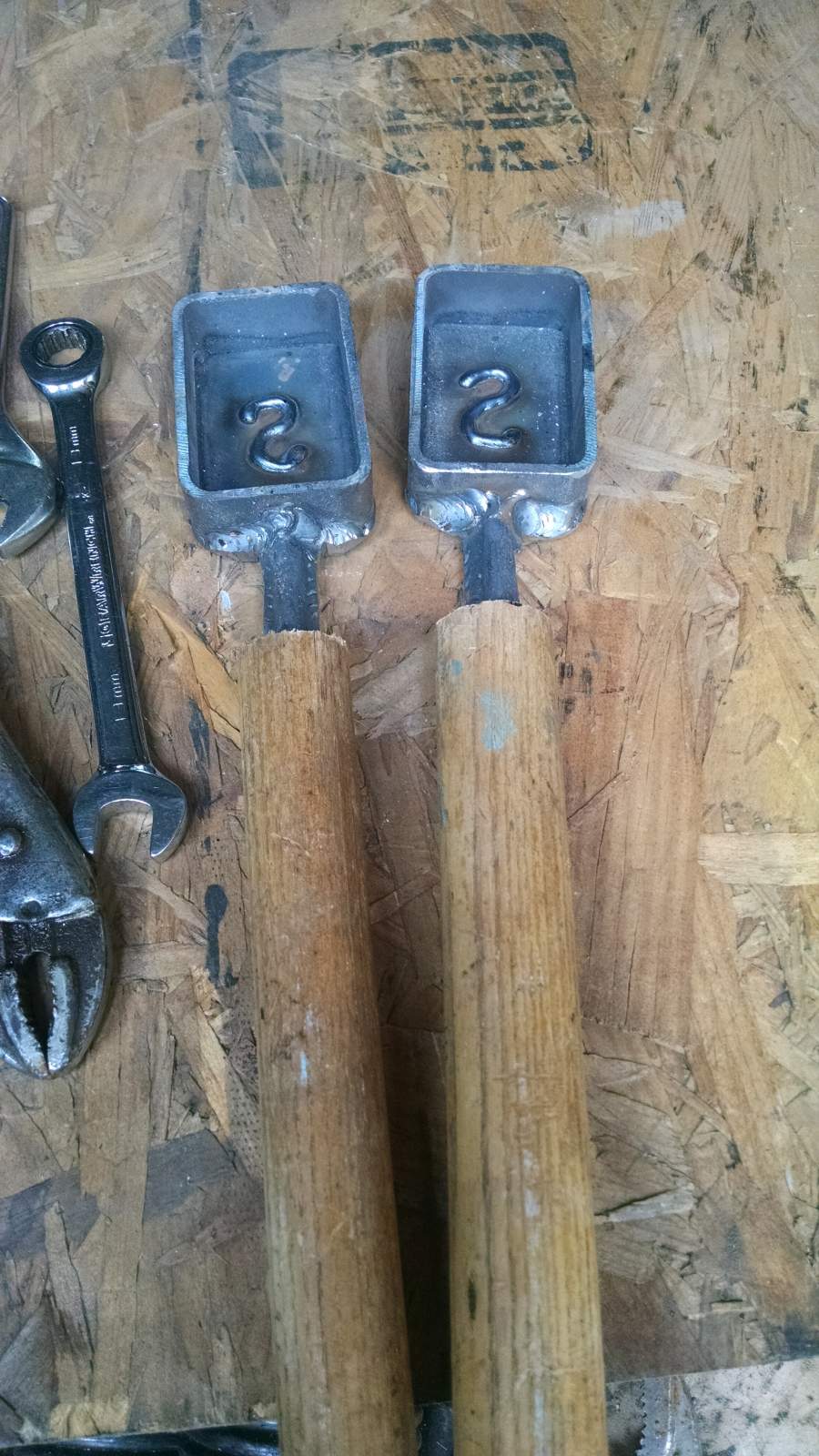

    Since I have several ingot molds, I think I will alter two of them to add an "S" for soft lead to the form. (That way they come out, premarked):) IMG_20150623_163305902. IMG_20150623_163801377. IMG_20150623_170248591.

    [​IMG] New addition for the soft lead ingots. May start cleaning and fluxing soon. Next step will be the mold. @Gator 45/70 , did you find one worth buying from you, or shall I go new?;)

    Geez, mate, the Ss are backwards?? :lol:

    Um ...[doh]
