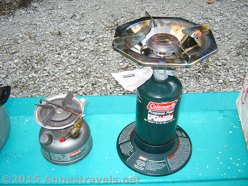

    The propane stove pictured above is the 10K BTU model, designed to be supported by a 16 oz fuel bottle. The Vendor lists these obvious 'features'
    • Features a large 8" burner bowl
    • Uniquely designed pot support system distributes heat evenly
    • Designed to help reduce cooking time
    • Output is fully adjustable from simmer to full boil
    • Features a 10,000 BTU high performance burner
    • PerfectFlow regulator provides a consistent cooking performance by producing a steady fuel stream even in cold weather, high altitudes and when fuel is low
    • Limited manufacturer's warranty
    • Model # 2000010642
    The first and most important feature, and something true for most propane stoves is the range of output. Setting these to simmer a dish is no problem, unlike the stoves reviewed earlier. This burner was made to cook with. Sells for around $30 USD, shop around as puce varies with vendor. .

    Pros -
    • Easy to set up and easy to light
    • The burner bowl helps to concentrate the heat.
    • Designed to use the ubiquitous 16 oz fuel canister.
    • Will fit on the top outlet of the Coleman bottle tree - here is a photo of the extender
    Cons
    • Designed to use the ubiquitous 16 oz fuel canister. While the narrow diameter 14 oz bottle could be pressed into service, it would be one of those 'emergency' cases..
    • Sensitive to the wind, just like most 'camping stoves' - it is tall enough that finding a windscreen could be a problem/
    • No fuel gauge. Short of carrying an accurate scale, knowing how much fuel is left in the canister is a bit if a crap shoot.
    These small-bottle fed units are problematic in cold weather. Since Bernoulli's principle applies, I've found through personal experience (and ruined meals) these type of fueled appliances to be all but worthless in cold weather. I have white gas stoves, lanterns and kero heaters for a reason.
    While the unit has a wide base, it is still less stable that other choices, this is further compounded by the height of the unit.
    Bottom line : These are a good choice for storage at home for utility outage where you will be cooking a firm surface, indoors for the most part. For a few days. The fuel stores well, with some cautions, and is safe to use. .
