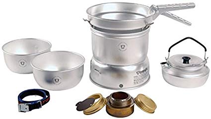

    The Stormkoker

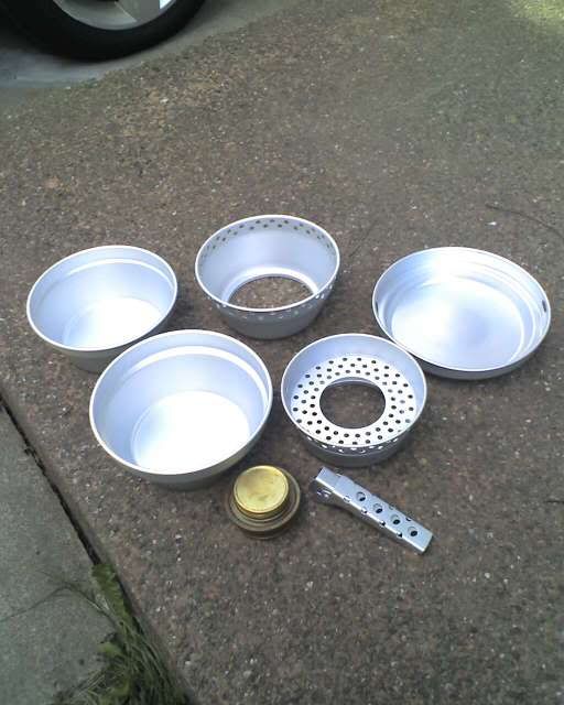

    Burner w.simmer ring, support & wind screen, two pots, fry pan, handle and the optional .6L kettle. A strap to hold it together. New cost - ~$100 w/kettle. Prices vary by Vendor, it pays to shop around.
    This initial post will focus on the Trangia system - the now, well known, Stormkoker. The company still based in Sweden. Be aware that a lot of their gear (knockoffs) are Hencho in China.
    The stove system is based on an brass alcohol burner, and a gas burner is now made to work with the system. The alcohol burner is available separately (~$15 USD) The gas burner is also sold as a retrofit item for older Stormkokers - you will need to cut a good-sized hole in the side of the windscreen however. I've not bothered.
    My Model 25 was picked up at a GROJ sale for $40 USD, a bargain. When i picked it up from my DD, the pots were covered with soot - the prior owner had used them to cook over a campfire. A waste IMO.
    They scrubbed clean and work well. The optional point 6 liter kettle is a must have, at least fro me.
    The pots vary in size based on the Model number (25- or 27-) and are adequate for 1-2 or 3-4 person cooking. The Trangia burner has a 'simmer ring' which allows for cooking things like rice dishes, stews, soups and so on. The kettle will boil water quickly for coffee, tea and instant soups.

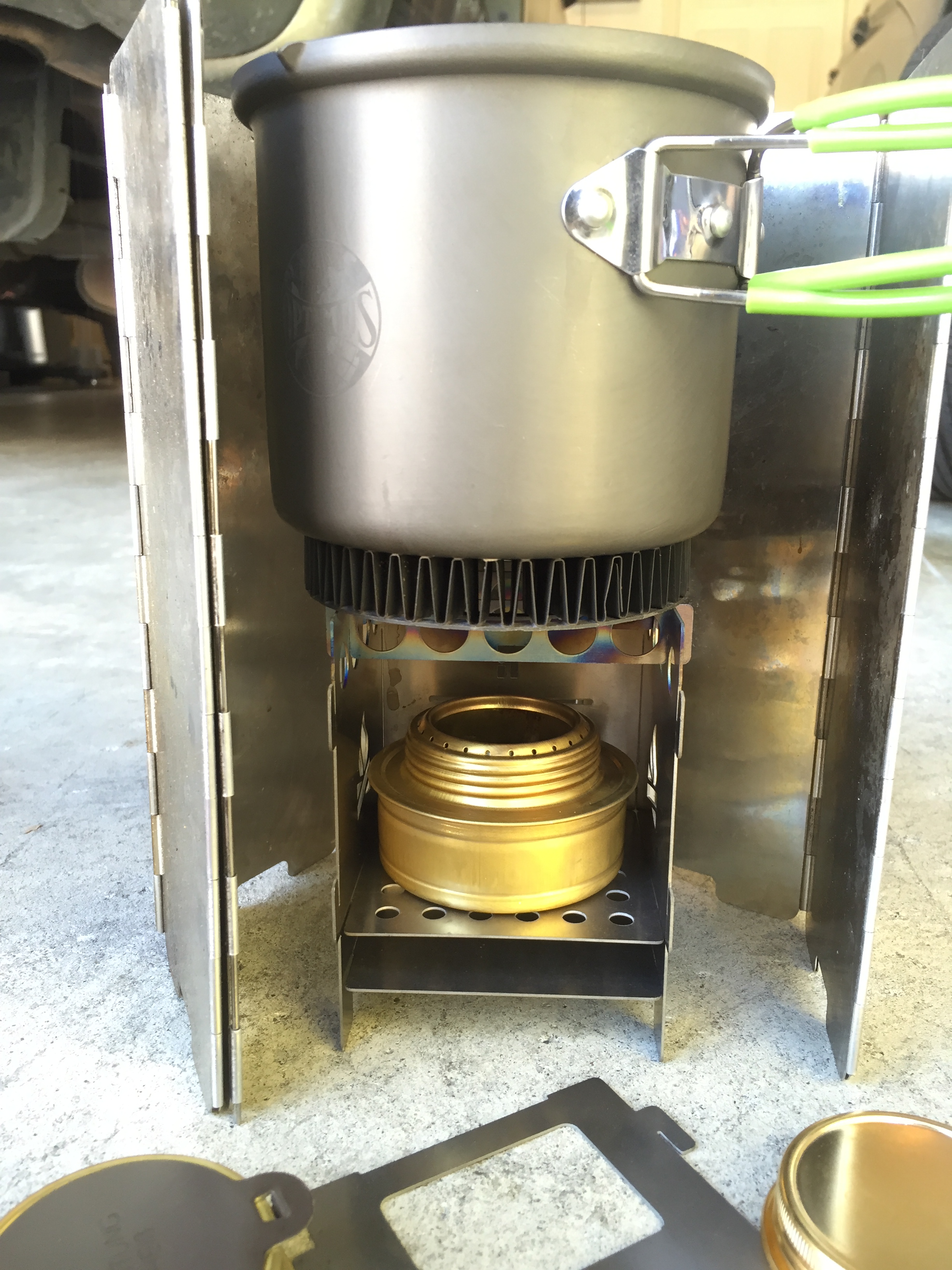

    I have a Bushbox stove and it works nicely with the Trangia burner and Esbit equally well. You will need a windscreen with anything other than the Stormkoker.
    I have recently added a Trangia burner to a Sterno Inferno cook set. That system will boil water quickly - so it is in Das Auto. This simply due to the much smaller size of the Inferno system.

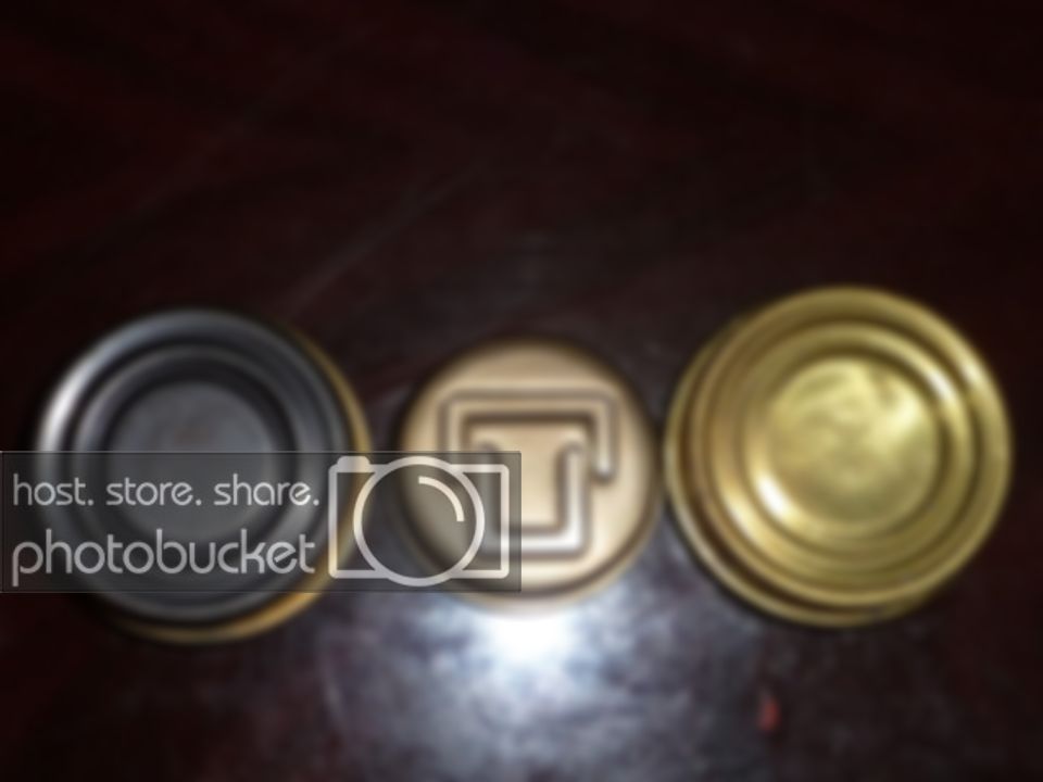

    a lot of different pot stands will work with the spirit burner.
    knockoffs have been known to melt.
    a Trangia has a T stamped in the bottom. A .mil unit is to the right.
