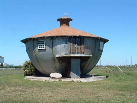

    looks like an old Russian escape pod
    As far as the grain bin conversion that 2X4 and ceiling joists wont hold as it is depicted. People stuff houses furniture is not the heaviest but books carpet and flooring are carpet gets heavier in time. If there is nothing directly under those joist they will slide and screws or nails are nothing compared to an upright with the joist parked on top. as far as what looks to be 2X4 studs the amount of insulation compared to the cost effectiveness of electrical use over time is not cost effective.
