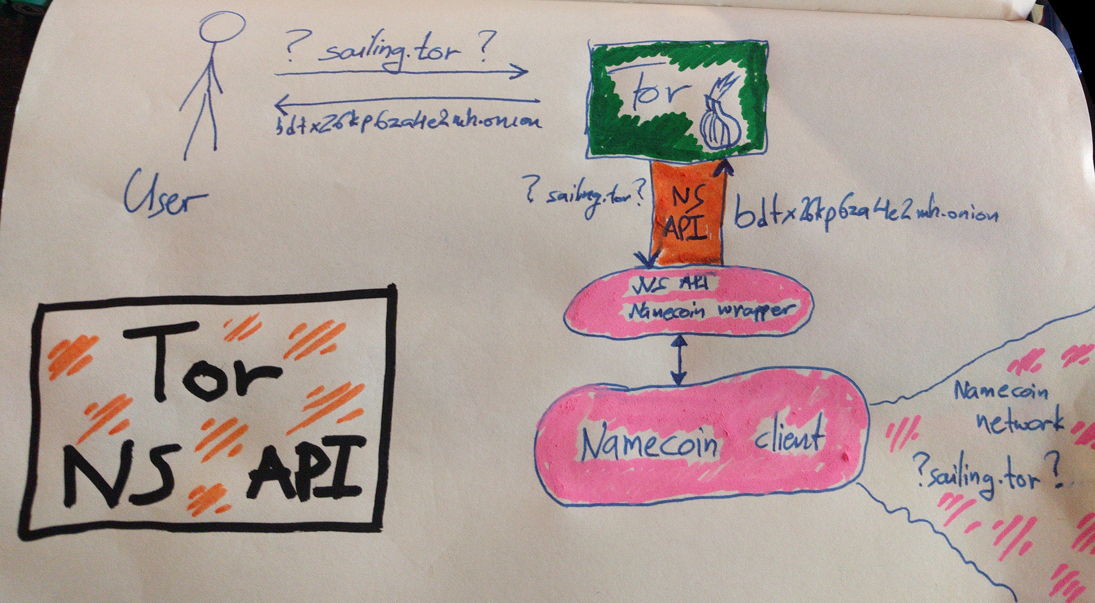

    Idea 1) A modular name system API for Tor onion services
    During the past years, many research groups have experimented and designed various secure name systems (e.g. GNS, Namecoin, Blockstack). Each of these systems has its own strengths and weaknesses, as well as different user models and total user experience. We are not sure which one works best for the onion space, so ideally we'd like to try them all and let the community and the sands of time decide for us. We believe that by integrating these experimental systems into Tor, we can greatly strengthen and improve the whole scientific field by exposing name systems to the real world and an active and demanding userbase.
    For this reason and based on our experience with modular anti-censorship techniques, we designed a generic & modular scheme through which any name system can be integrated to Tor: Proposal 279 defines A Name System API for Tor Onion Services which can be used to integrate any complex name system (e.g. Namecoin) or even simple silly naming schemes (e.g. a local /etc/tor-hosts file).
    Here is a graphical depiction of the Name System API with a Namecoin module enabled and resolving the domain sailing.tor for a user:
    It's worth pointing out that proposal 279 is in draft status and we still need to incorporate feedback received in the mailing list. Furthermore, people have pointed out simple ways through which we can fast-track and prototype the proposal faster. Help in implementing this proposal is greatly appreciated (find us in IRC!).

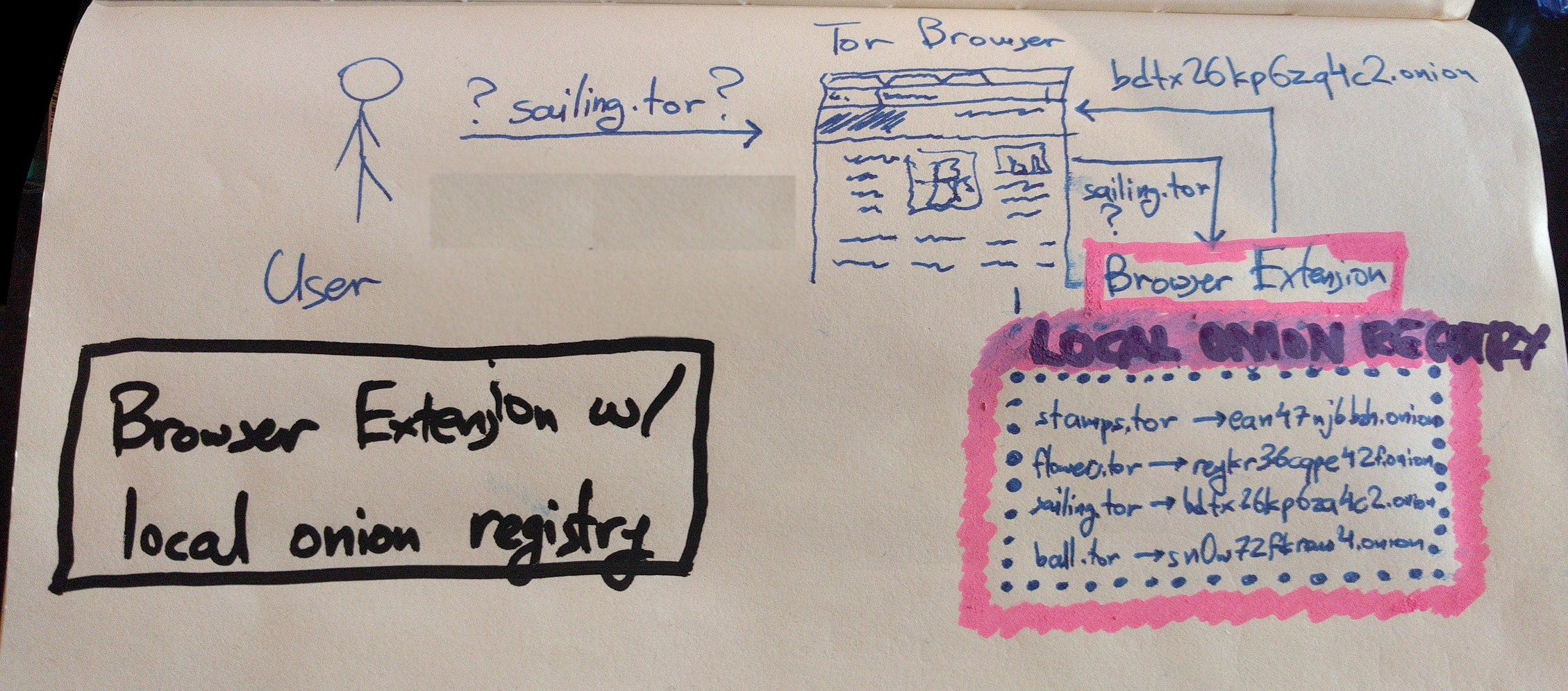

    Idea 2.1) Browser Extension + New pseudo-tld + Local onion registry
    A browser extension like HTTPS-everywhere, uses an onion registry to map human-memorable addresses from a new pseudo-tld (e.g. ".tor") to onion addresses. For example, it maps "watchtower.tor" to "fixurqfuekpsiqaf.onion" and "globaleconomy.tor" to "froqh6bdgoda6yiz.onion". Such an onion registry could be local (like HTTPS-everywhere) or remote (e.g. a trusted append-only database).
    Even an extension with a local onion registry would be a very effective improvement to the current situation since it would be pretty usable and its security model is easy to understand: an audited local database seems to work well for HTTPS-everywhere. However, there are social issues here: how would the onion registry be operated and how should name registrations be handled? I can see people fighting for who will get bitcoin.tor first. That said, this idea can be beneficial even with a small onion database (e.g. 50 popular domains).
    Here is a graphical depiction of a browser extension with a local onion registry resolving the domain sailing.tor for a user:
