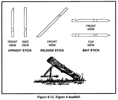

    Throwing spikes are usually much like throwing knives (tapered at both ends wider at the center mass.) I was thinking of interlocking notches for the trigger function and perhaps a square shank on the trigger end with a bait lever to slide on to it. Any movement of the bait lever (at right angles to the trigger lever) would unseat the notches. Bait lever would be barbed for bait. Bait lever could be secure to trigger lever simply by a wrap of paracord or wire of which could be laid as a secondary tripwire.
    Figure four trigger mechanism could serve as a tripwire warning system by dropping rocks or fire logs against washtub or gas cans. (As well as possibly catch dinner) that is why I'm thinking multi function (one device to carry, several possible uses) trap, cooking skewer, pot holder, noise maker, defense, fish stabber, tent stake, bait hole maker for leg hold trap or snare wire......:)

    @kellory thanks for the info... and the graphic....
    Still trying to grasp how thick and long the "spikes" would be...
    I've got 5/16 stainless round bar... thicker? how long?
    Or are you thinking a different shape....
    Easy enough to drill holes... to add line... or even a barb for gigging... thicker would be a bit unwieldy and heavy...
    Stainless wont rust... easy to shape, drill modify or tune....
    Thoughts?
  12. kellory
    I think it would have to be heavier to throw, perhaps 3/8"-1/2" and perhaps 12-14" in legnth. and round bar will likely not seat well for locking notches. Hex bar or square would lock together better I think. Depends upon the method of release. Typical figure four (as shown) holds by surface notches at the tips. What I Invision is more like Lincoln logs with locking notches so the figure four could lay nearly flat (assembled) but with one extra piece (bait lever) who's job it would be to rotate the notches apart by sliding onto the trigger lever and rotating it as the bait is being touched.notches would be shallow, but fully complimentary to each other piece. (Sorry, but I can't draw any pictures with a phone.)
    What I see would be notched only on the sides, not the top or bottom.

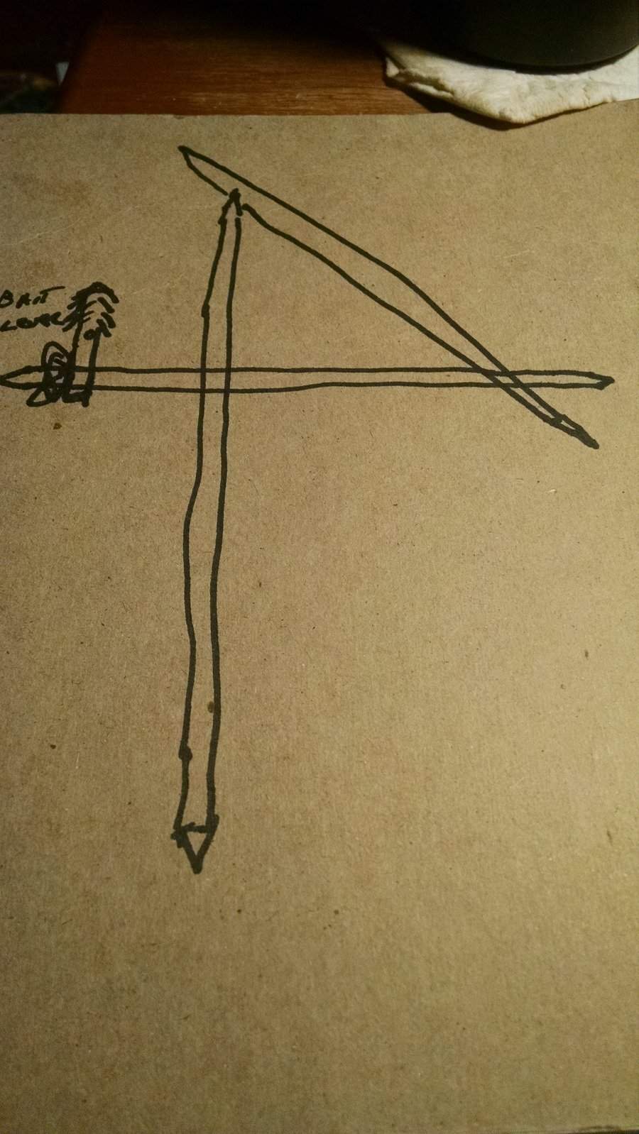

    Keep in mind, there is good reason I never went to air school. When I lay out material I use squares and straight edges....
    Bear likes this.
  20. Bear
    LOL @kellory now I get it... the weight bearing slanty piece is cross notched at an angle in the body instead of at the tip ... do I have that right?
    What's that thingy at the end of the trigger? marked bait? is there a hole there or is that notched or something?
    These would be tapered to a sharp tip?... so 3 throwing sticks with tips at each end?
    kellory likes this.
