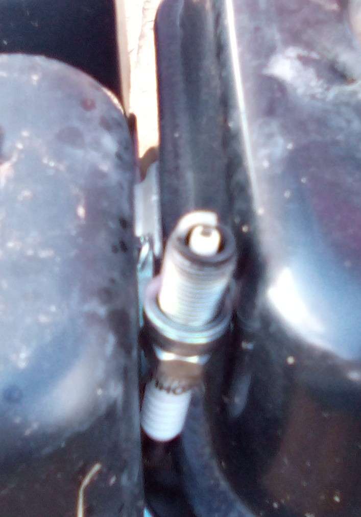

  9. oil pan 4
    I have ran it at least several hours since last time I messed with the carb.
    Still nice and white. That means I'm not wasting spark plugs and I'm not wasting gasoline.
    Now to increase engine power and efficiency further by advancing the ignition timing and going to a super thin head gasket.

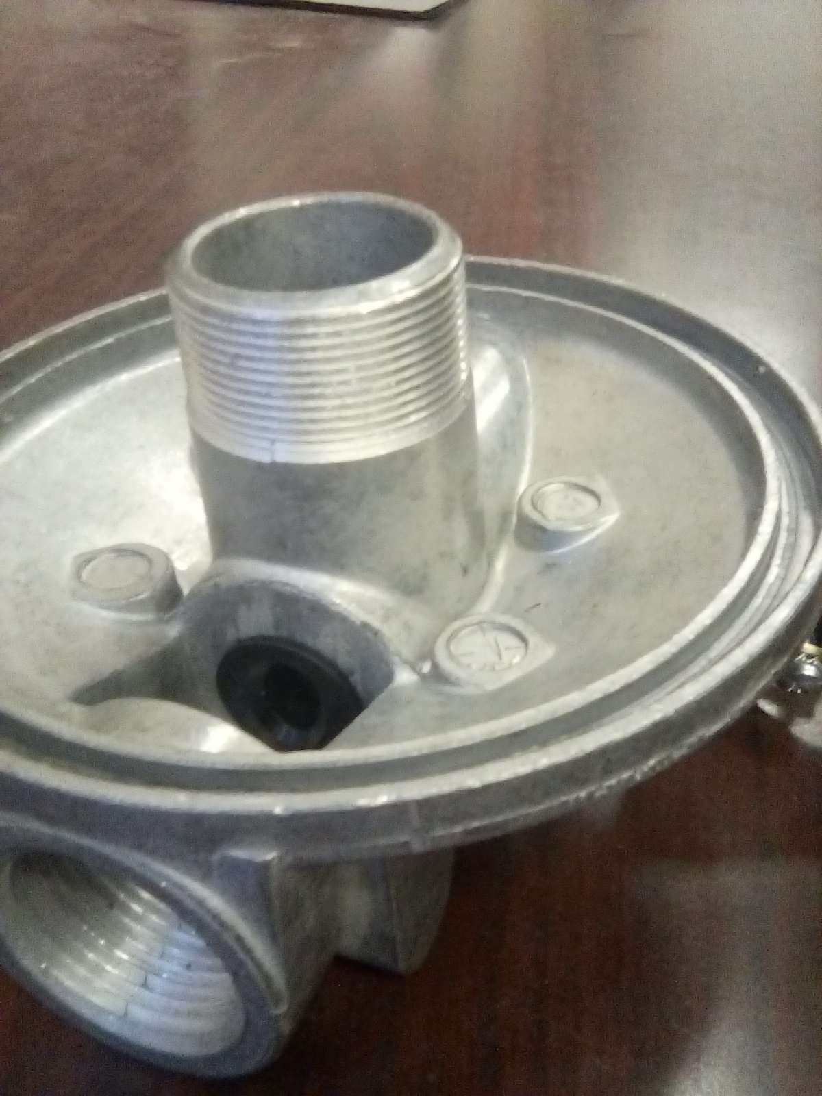

    I got a new hydraulic upgrade.
    I found a 1.5 inch 16tpi thread hydraulic filter head in the trash at work. They took the filter off and tossed the head. Knowing hydraulics international they probably speced a 25mu hydraulic filter for that piece of equipment, so I don't want the free option.
    This filter head typically takes a 5 inch wide by one foot long filter. But I have seen 16 inch to 2 foot long version of 1.5-16thread 5 inch wide filters. A foot long one will be way more than enough.
