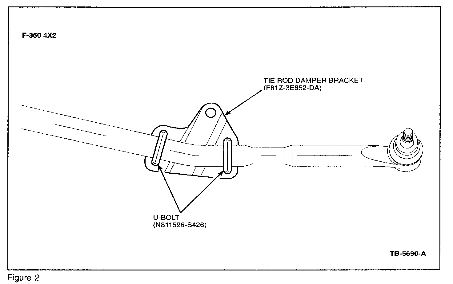

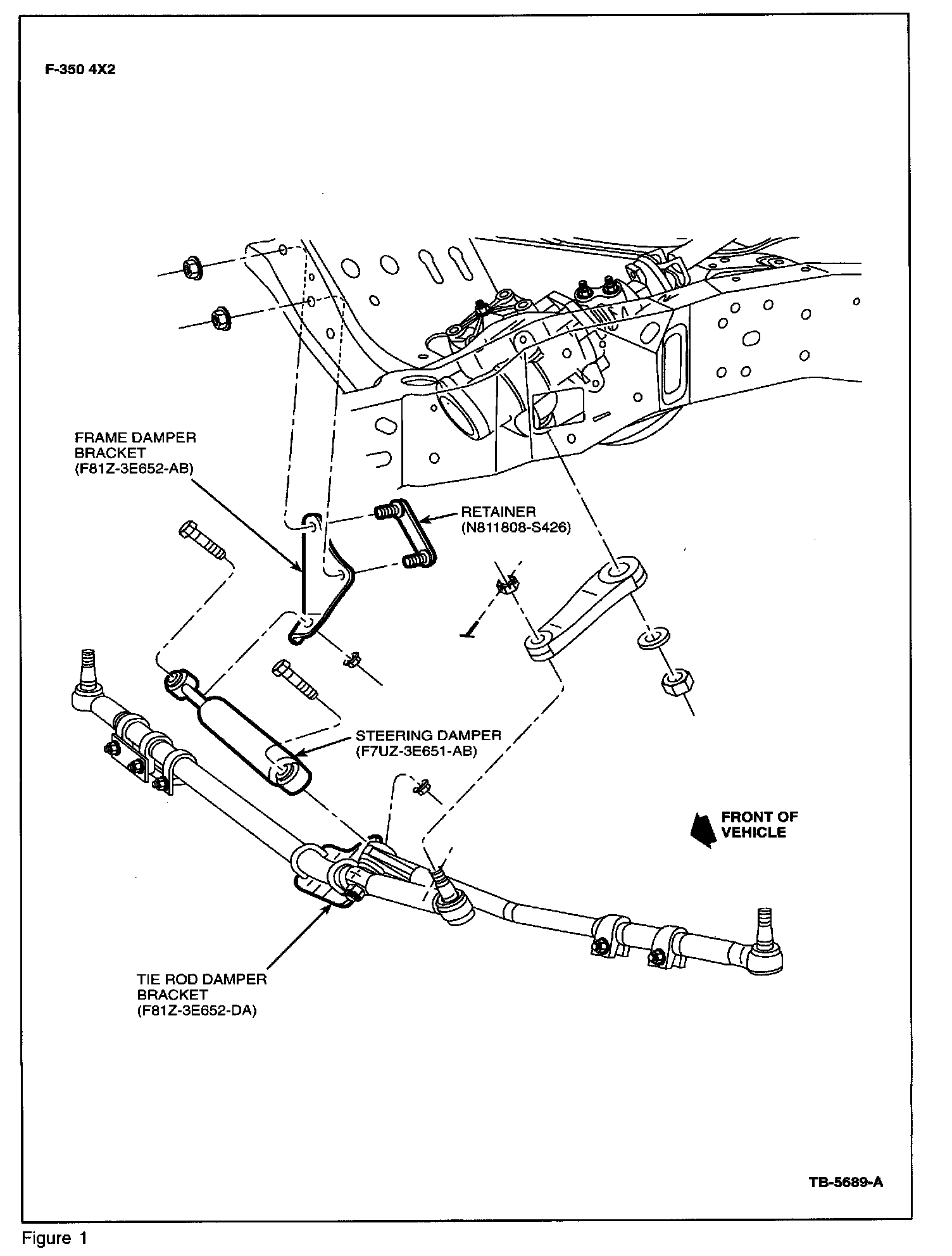

    Ford has a TSB for you, @Tempstar :
    FORD:
    1999-2004 F-350, F-450, F-550
    This article supersedes TSB 99-08-2 to update the vehicle model years.
    ISSUE
    There may be a steering wheel tight after hitting bumps or ruts in the road on some vehicles. This may be caused by steering geometry and/or vehicle loads.
    ACTION
    Install a steering damper on vehicles if the damper was not factory installed. The damper will help control steering linkage and reduce the possibility of wheel fight. Refer to the following Service Procedure for details.
    SERVICE PROCEDURE
    DEFINITION
    Some regular cab F-350/450/550 chassis cabs may exhibit wheel fight when the front tires encounter a road irregularity such as a pothole. Wheel fight results in a slight single jerk (5-10 degrees) of the steering wheel and should not be confused with wheel shimmy. Wheel shimmy results in a continual oscillation (5-10 degrees in each direction) of the steering wheel and usually can only be controlled by bringing the vehicle to a complete stop.
    INSTALLATION INSTRUCTIONS F-350 4X2
    1. Mount Frame Damper Bracket (F81Z-3E652-AB) to right forward side of front crossmember using two (2) M12x70 Bolts (N606084-S426) with two (2) M12 Nuts (N620483-S301).
    2. Torque to 90 N.m (66 lb-ft) (refer to Figure 1).
    3. Mount Tie Rod Damper Bracket (F81Z-3E652-DA) to the bottom back side of the tie rod at the V" with the damper mounting hole of the bracket orientated up and 45 degrees to the rear. The bracket should be positioned with the bracket edge 40 mm (1.57") from the drag link ball stud (refer to Figure 2).
    4. Use two (2) M8 U-bolts (N811596-S426) with four (4) M8 Nuts (N620481-S301) and torque to 28 N.m (21 lb-ft).
    5. Mount the piston end of Steering Damper (F7UZ-3E651-AB) to frame bracket and cylinder end to tie rod bracket using two (2) M12x70 Bolts (N606084-S426) and two (2) M12 Nuts (N620483-S301). Torque to 90 N.m (66 lb-ft) (refer to Figure 1).
    6. Cycle the steering wheel full left and right turns to ensure all damper components have clearance to other components and that the damper piston does not bottom out. The damper cylinder clearance to the front crossmember in full right turn should be no less than 6 mm (0.25").
