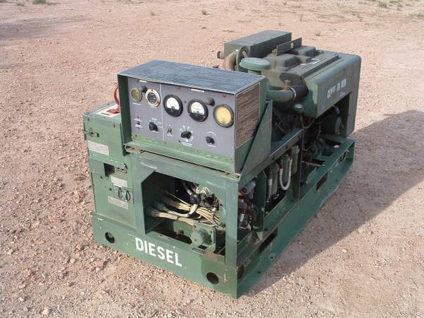

    Jump on it Az. Not sure what those pipes are, but MAY be related to the off skid fuel system. (Don't take that to the bank.) The price looks to be in line.
  13. BTPost
    Those are the outputs of the Exhaust Manafold for each of the two, two Cyl Banks... Looks to be unmuffled... That is a MEP003, which is an Onan DJF Engine, turning a .MIL Spec Genend... It will put out up to 12.5 Kw with ease, and the .MIL Rating is 10 Kw.. The whole AC side is .MIL Spec, but the DC side is 24Vdc... Starter, GlowPlugs, Control Systems and Electrics... I think I have the Depot Maintainance Manual in PDF somewhere, back home...
    Light in the Dark and ghrit like this.
  14. azrancher
    azrancher Monkey +++
    OK, that makes sense, in pics 2&3 the hose shown to go into the air cleaner must be pre-heated by the exhaust manifold.
    No response back from an message I sent to his cell...
    Rancher
    ghrit likes this.

    Going to look at it Tuesday, what do you do for a muffler for that sucker! I suspect it will still be for sale for a while because he lives in the middle of nowhere on the AZ-NM border... @BTPost you could have stopped by and picked it up for me, dang.

  20. OK, so as stated thats an MEP-003A. They are beasts! Has the seller verified that it runs? Have you SEEN it run? One of the most common foul ups on these older units is the injector pumps. If they have not been run consistently, or in a while, the plunger can stick, and then you need to take the IP out and rebuild it (parts are still available from AMBAC thankfully).
    It has three fuel pumps (one auxiliary and two for main use), as well as inline EMI filters (these filters can fail easily, and shut the machine down... you can cut them out, and rewire back to the jack, and be operational again). One water/fuel separator, and two fuel filters. Very simplistic, but very rugged machines. A muffler will do little to quiet this beast (most of the noise is going to come from the genhead, actually).
    Will do single and three phase (120 single, 120/240 single, and 120/208 3ph).... user selectable.
