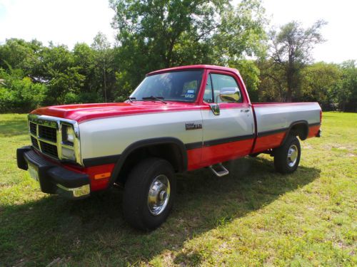

    in the '65 Power Wagon
    5.9 Cummins.

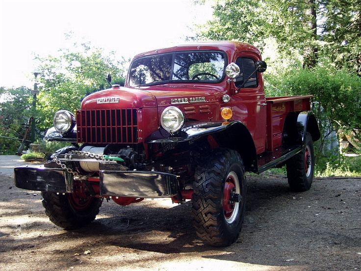

    Here's one of the very best things you can do with a Cummins! My 42 Dodge Power Wagon project! BT-4 3.9 punched out to 4.2 and Holset 3125XX turbo, 80HP upgrade Cali spec injectors, and "green" fuel plate! Should make about 375 HP with this set up! Once I get the body all put back on it, I will be adding a charge air cooler to it!

    I shared this before, but every one loves it, and I gotta include it in this thread! My 46 WC-30 1 ton P.W. with identical Cummins set up! 19 MPG and you KNOW your driving a truck with this one! I love these trucks!!!

    Now that's a truck!^^^^^
