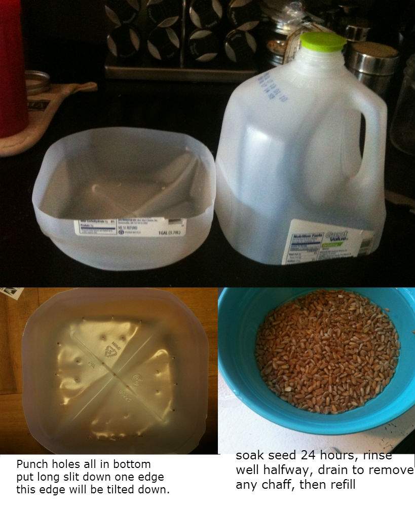

    I saw this fodder system in the FarmTek catalog and just drooled, but at $3000 for the smallest system, it's hardly feasible for 8-10 rabbits. HOWEVER....
    I am going to see if I can build my own. I have an idea for a sort of self watering gutter system but for now I'm going way cheap until I see how the buns do on fodder over pellets. If it works the way I've figured, I should be able to ditch the pellets and just feed the fodder and dry hay. Got it started, and so far so good using winter wheat, gallon water jugs, and a greenhouse flat.

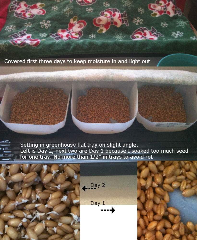

    So here's day three and four. I know it's kinda lame but I'm all giggly about it. *I* think it's pretty cool.

    Day five and six, plus of the whole "system". I'm thinking tomorrow I can pull the first batch out and feed it. It's crazy how fast it's grown! The early trays were 3 handfuls of wheat seed, while the later ones were down to 2.5 or just 2. I'm thinking 2 handfuls is enough as it really bulks up fast and I'm a little worried about rot when it gets that thick. I've been spraying it under the kitchen faucet 3-4 times a day, and on the first few days propping them on an angle to drain better and covering them with a dishtowel. Days 4-6 are out in the open to catch some light from a northeast facing window.
