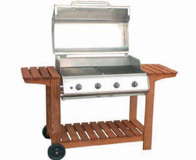

  10. chelloveck
    Vermiculite has better insulation qualities than sand, less mass than sand, and the sand itself will draw quite a bit of heat from the cooking chamber.
    Other improvements might be to seal the outer surfaces of the pots to minimise moisture penetration into the pot. Unglazed pots are porous and will absorb moisture. Enclosed moisture and heat are not a good combination...which may cause the pots to crack or shatter.
    Lining the inside surfaces of the pot containing the vermiculite insulation with aluminium foil may help reflect some of the heat back into the insulated mass, keeping the internal oven temps higher.
    Keeping the oven out of the weather is highly recommended. The trolley idea is an excellent one. It isn't difficult to find unwanted gas BBQ trolleys being dumped at municipal kerbside trash collections. Some modifications might be necessary to ensure that the oven will be stable and won't tip off the trolley when it is being moved.
