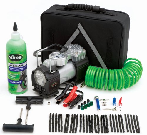

    Slime Kit all the way.[​IMG]
    60 some odd bucks Prime Amazon.com and more than just a expolsive can in your trunk.
    I have one in each vehicle and a small one on the Indian and a midsize in the Boata.
    Just daily prepping in the real world and with the cost of tires above 2C then a good cost efficient way to stay on the road.
    So easy to use even a LIB can find a homeless person to use it for them.
    5 Bucks$$$ and the LIB stays dirt free.
