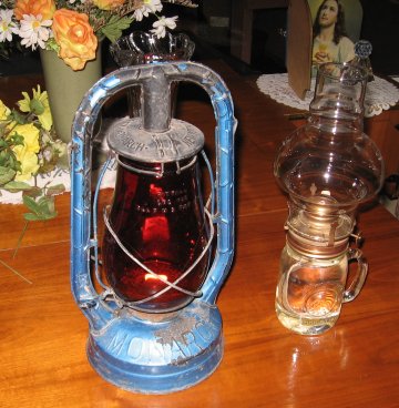

Do you know what this is? Oil Lamp

  13. Ura-Ki
    Dawn Dish Soap in HOT water will do the trick! I find breaking the lamps down and putting the affected parts in a big stainless pot and boiling them in the Dish Soap for several min usually does the trick! If not, one of the Non Chlorinated Automotive brake-kleen spray cans will soak all the crap outta them pretty quickly!
