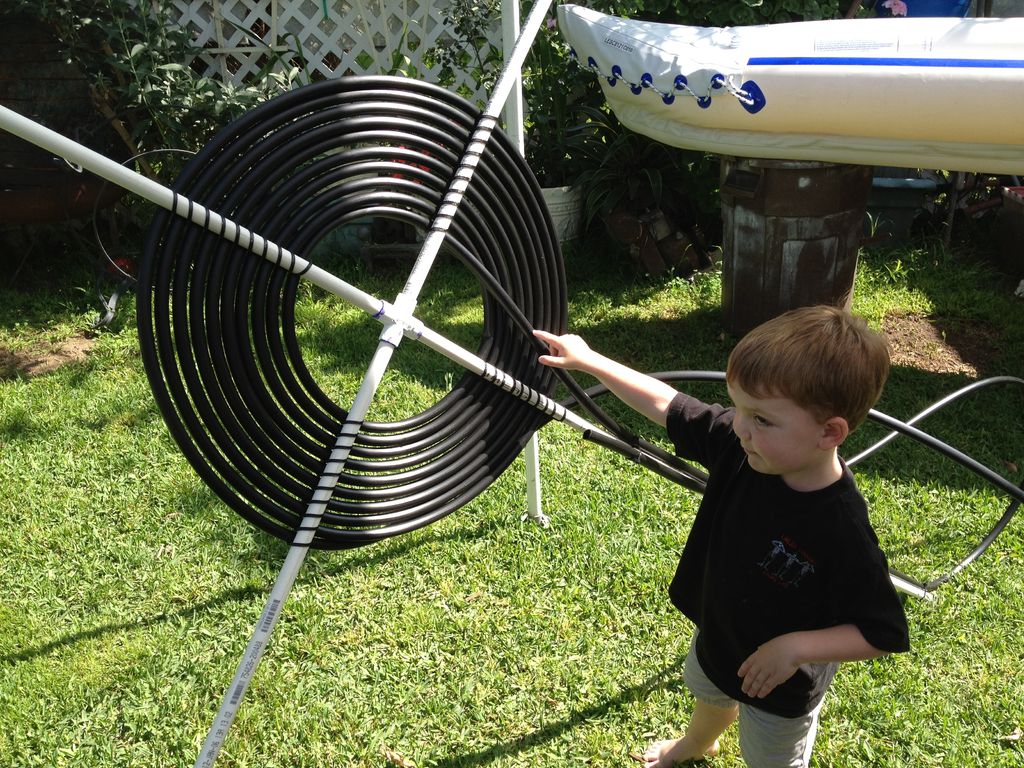

    Excellent content, helps me get ready to set up the castle basement log burner and hot water in cold months. Here's the type of warm weather water heater we will use, except ours will be massive, huge pipe and at the top of a tower. Ever grab a water hose on a warm day? Same concept...except black PVC pipe will get even hotter

    Yes, greenpowerscience.com did a rooftop solar water heater for a shower.
