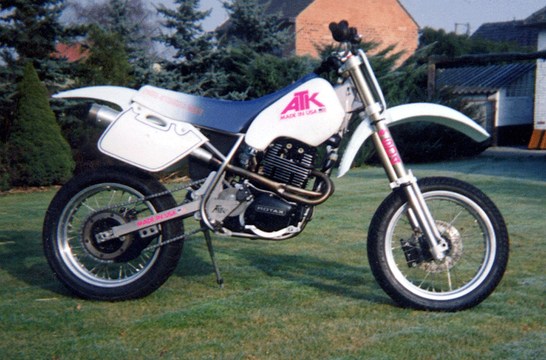

  4. Ura-Ki
    Here is the ATK with out the racks installed yet, but with the rims and tires.

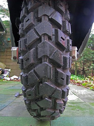

  5. Ura-Ki
    Here is the Wife's Husky with the racks removed ( has quick mounts) and the new Tires.

  7. Bandit99
    That is a street legal also? I am very interested in a dual purpose type bike. I use to have a couple of enduros and loved them. When I went overseas those days were over and moved to street bikes. My favorite was an old BMW RS1000 with bags, drove it all over Europe, the UK and Ireland (North and South). I was even considering driving it to Moscow but got sidetracked by some crisis somewhere and left Europe and my bike never to return. Anyway, I am very interested now in a Dual purpose bike so any recommendations you can give would be appreciated. Like you I am interested in something maneuverable but with plenty of power to easily carry two people, rugged and reliable. It would be nice if it was easy to maintain but I know nothing can compare with the old Beemers for that... Anyway, My first question is are ATKs that good? How would they compare to say a Honda? I never even heard of them but that's not unusual. PM me if you wish if you think others might not be interested...
  8. Ura-Ki
    I would go out of my way to find a Good ATK hands down. Thew were the BEST in the world back in the late 80's to the late 90's and still building bikes today right in Salt Lake City, ( used to be in L.A.) and sold through Harley Davidson dealers. Second choice would be Husquvarna ( just not the Chinese powered ones) or a Husaburg. A Great bike to dip your toes into would be a Suzuki DS400 or a Kawasaki Sherpa! I like any bike in the sub 600 cc range to keep it light and nimble, a Honda XL650 is about the heaviest of them all. if a person had the money, a good KTM wouldn't be a bad way to go, there are ton's of aftermarket parts and really outstanding support for them ( helps to be world champs for several years) so there are a lot of different bikes out there. I recommend an Enduro because they can be licenced for street use, and mainly because they all ready have a charging system for running lights and other electrical stuff. Most ROTAX powered bikes have an alternator vs a generator and that makes a huge advantage in their favor. E bay and Amazon are great places to find aftermarket parts, and Actual racks and rack systems can be found through BMW and Triumph Dealers. Tires can be found at any shop that deals in Duel Sport bikes. DOr a more aggressive off road biased tire, Pirelli Scorpions are a very goo choice.

  11. Ura-Ki
    ATK Parts
    ATK
    They come and go, hard to get a network up and keep it running for such a Boutique Company. American Dirt bike is the GOTO for parts and some good upgrades, and the forums have great info for every thing about these bikes. The 4 stroke ROTAX engines interchange with the early KTM, ( ATK actually had the patent for these) so parts are also available through KTM. Most ATK bikes have W.P. suspension systems, with a few having Olhin's ( like mine) and the Olhin's can source parts through BMW
