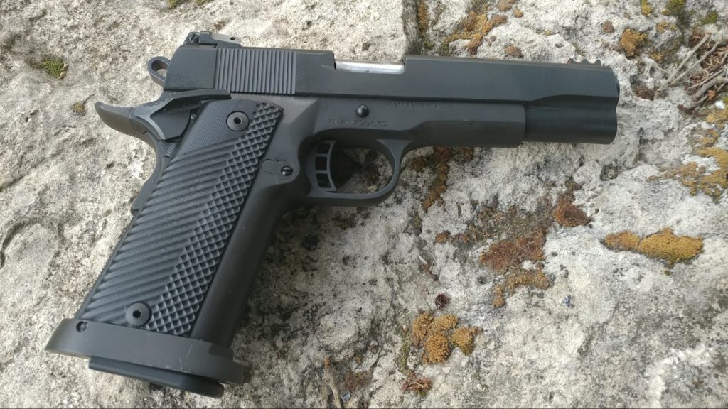

    That said, unless your stuck on it ( Or it's a super good deal) have a look at the Rock Island 1911 double stack 10 mm auto pistols!
    A stunning deal on a high cap 1911 in 10 mm with 17+ 1 capacity!

    @Ura-Ki Would you take the Rock Island over the Glock 20? I definitely want a 10mm in the future, maybe Christmas.
  7. Ura-Ki
    Ura-Ki Grudge Monkey
    Short answer, YES, HELL YES!

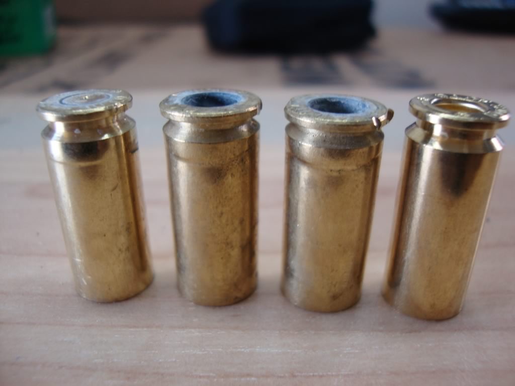

    Long answer, I have a Glock G-20 Gen 1 and while it's adequate, it leaves much to be desired! The problem with the Glock is it was never meant to handle full power 10 mm, and it doesn't have a fully supported chamber, which can cause feeding issues and could lead to catastrophic failure at worst! There is even the infamous Glock Smiley which is quite pronounced in 10 mm!
    The 1911 has proven it's self more then up to the task of handling Full NUKE power level 10 mm ammo reliably and with out issues!
    It took the 1911 industry a little while to figure out how to cope with that kind of power, but ALL production 1911's in 10 mm have ramped barrels and full chamber support! And, as a bonus, the 1911's double stack grip and magazines can hold more rounds then the Glock or any other standard type semi auto pistol, making it the top dog in power and capacity!
  8. oil pan 4
    If your gun bulges cases like that it needs to be donated to the fast and furious program.
  9. Ura-Ki
    Every Glock in 10mm does it, every time, the 1911's never!
    The hottest load the Glock can take is: 11.4 gr Blue Dot under a 200 gr Lazercast bullet @ 1106 ish FPS
    the Hottest I can safely get the 1911 to run is 13.6 gr Blue Dot under a 220 gr Grizzly Solid HP @ 1340 ish FPS!
    Any hotter and she starts to push primers back!

    Bulging cases, that's scary...to put it mildly. Doing a little reading, I guess changing to an aftermarket barrel eliminates this problem but who wants to purchase a new gun just to have to change its barrel to shoot it. I can't believe Glock has not jumped on this problem... Just the thought of it would put me off shooting it and certainly buying it...
    @Ura-Ki Is this happening with standard 10mm commercial rounds also or just the super hot rounds?

    Yes, factory stuff is bulging from a factory Glock, and whats worse, even the aftermarket barrels do not fully address the issue, i tried with mine amd I still get the Glock Smile on my brass!
    A lot of so called "Experts" have told me the Gen4 and later pistols have solved the issues, but having shot a Gen4 it was just as bad as my Gen1!

  20. oil pan 4
    So if 10mm gets shot in a glock the brass is scrap?
