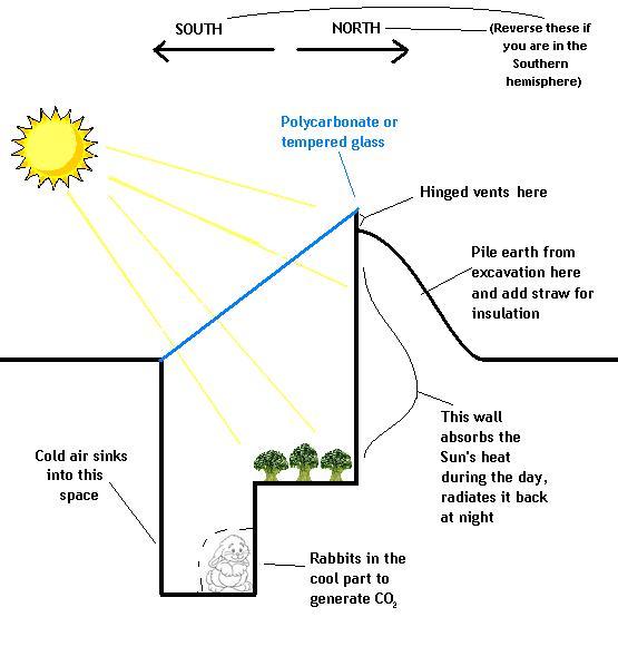

    This website has some ideas about building an earth bermed / sunken greenhouse. It may help extend the growing season for some folk whose location experiences shorter growing seasons than milder climates.

    Wonder how that will work in places with a lot of rain.

    Bermed, rather than sunken below grade...though, if you look at Oehler's set up. because he has built it into a fairly steepish slope, the lowest point of the set up is close enough to grade to drain the cold sink with agricultural pipe reasonably easily. Otherwise, a sump and sump pump may be a work around.

    Good idea to have a sump pump or drain set up because you don't want to drown your rabbits. jk
    Seriously- this is a really cool idea. Thanks for posting. Need to read more on this concept

    There is an area on my place that might be just right for this kind of arrangement .
    I don't get enough rain to be a problem , as a matter of fact creating a reservoir might be the ticket just below the green house.
    If the rain water is gathered into a settling pond then filtered into the fish pond that water can be cycled into the garden.
    I get just enough wind that could drive a mill for circulating the water from the pond to the garden .
