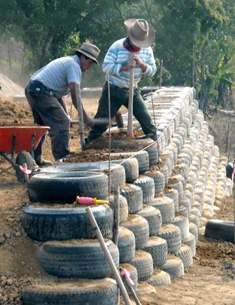

  17. HK_User
    FWIW, this is a better choice for a home built structure. JMHO
    xls said:
    There is also the fee option of tire constructed homes, tire center just give them away. And it offers a lot of defensive options.
    Sure and what most do not know is that the tires are filled first with a rammed earth inside the tire, then the tire is layed in place and more rammed earth fills the center. A whole lot of time and labor as well as material aka dirt, that takes time to collect and mix.
    HK>>>>
    Rammed earth
    tire structure would be the least expensive and the most labor intensive, but IF I had to rebuild then that is what I would have. With re-bar at each layer and then vertical placed re-bar. Each tire would be tied to the tires above, below and the ones next to it.. Lath work and concrete for the inside and outside, no ditzy thin layer of sand, air and thin cement mix for me aka stucco.
    [img id="yui_3_10_0_1_1454624313742_1689" src="http://4.bp.blogspot.com/_AmmDnnMutP8/TClUW9q5cHI/AAAAAAAAANM/SAU9OZlo7qg/s1600/DSCN0205.jpg" alt="BRIDGES: Earth Tire Construction with Long Way Home">
    Note the "Concrete Beam" on this design below. This Concrete Beam is the key in any structure of this type that provides a strong connector for the wall structure and for the roof. This type "Concrete Beam" should also be used in any concrete block building.
    [img id="yui_3_10_0_1_1454624313742_2270" src="https://es-media-prod.s3.amazonaws....ef1a2ada/e8bd8c0bc6dc45e899281212bb4d25bf.png" alt="Cronk Earthship ( house), rammed earth, passive solar">
