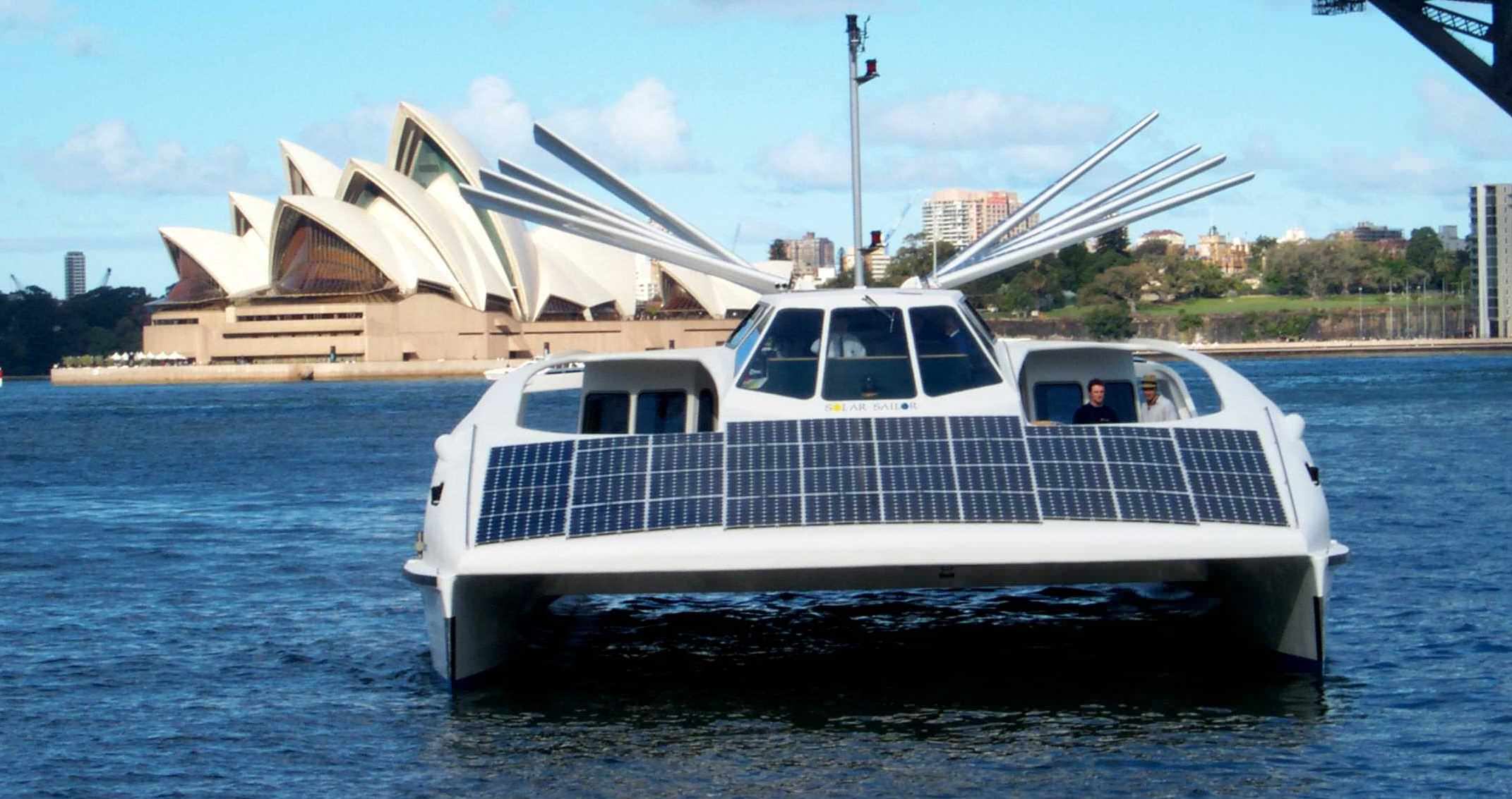

  9. kellory
    You have to go huge, high dollar, and high efficiency to go solar.
    This is the Solar Sailor. [​IMG]

  10. birddseedd
    birddseedd Monkey
    I think iv got enough room for the panels that are on the front of it. maybe not the top without doing something similar.
