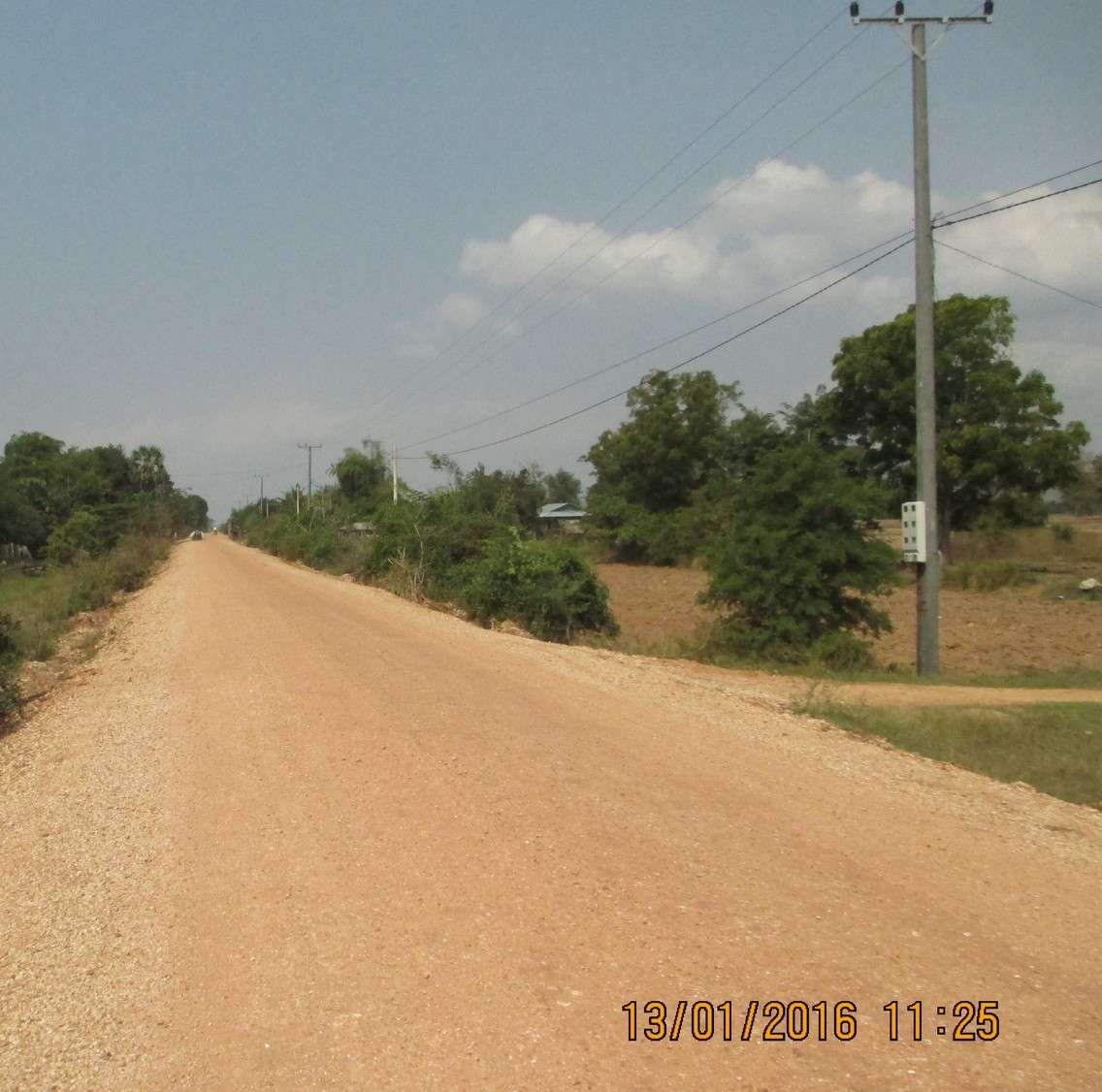

    Here is a photo of the pole, where the power company will connect our service.
    There is a meter inside each of those boxes. But, we are still required to buy another one that will attach to the farm house. (God only knows why. And, I am not brave enough to ask such a question.)
