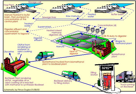

  18. DKR
    Related - waste to biodiesel. Pig farms produce a lot of smell if the manure isn't handled correctly. You can smell them for miles down wind.
    So, why not make money with all that sh... waste product? Smithfield Pig Farms - Utah (now owned by the Chinese)
    Process.
    The Utah project is a combination of technologies that recover the energy contained in swine manure and turn it into a usable and marketable fuel. This project will tie into Smithfield Foods' Skyline complex and include 23 farms with a total of 257,000 finisher pigs, all within a 5-mile radius. ( see more at Manure to Energy - The Utah project)
    Utah Finishing Farm is Environmental Steward Winner
    Large scale bio-digester - to electric power and reduced odor. We used to drive past this farm - the smell was enough to pull the paint off Das Auto.....
