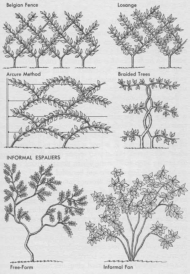

    I had never heard of espalier. I looked it up and it is beautiful way to grow trees. I copied a chart and some get real fancy with their design.
    f5dbee9f0e4da0cb7efa62dbf04968b2.
    Duane is correct that the wall will help heat the ground and trees. It should extend their growing season.
