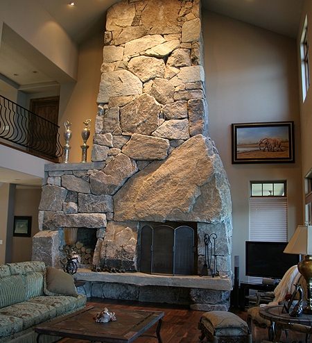

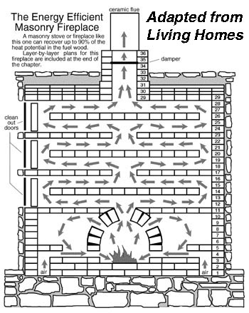

    I hope to have at least an 8x8 pillar of stone running from the basement to the roof in the new place. I hope to warm that mass and then keep it re-radiating all winter-- something like this on the inside and
    . . . something like this on the outside:
    The good news is I have pile of field stone as much as 10 feet high all over the property. I just need to drag it back to the site.

    You design leaves a lot to be desired... As CS stated, How do you clean the Creasote out of the Burnt Gas Path... That is REQUIRED, if you don't want a Chimney Fire, Down the Road... Most properly designed Chimney Systems have separate Air Channels built in to the design that hear Room Air... Fancy ones use 6" Steel Pipe, that has Raw External Surface Area inside the Fire Flue, that act as Heat Exchaners... Also FirePlaces are not really the best at burning Coal, as opposed to FirWood...
  15. shaman
    shaman Monkey++
    There are cleanouts on the side for the convolutions, but I suppose there would have to be another cleanout for the main chimney.
    I'm was originally thinking of the fireplaces as a supplement to a coal furnace couple with a geo-thermal heat pump. From what I've read, guys with a coal furnace often supplement with oil or some such easy fuel. In the coldest months, they run it all. In fall and spring, they use just the oil to keep it simple. I'd think a geo-thermal could do the job of the oil down to below 20 degrees, and then start stoking the coal furnace and the fireplaces.
    Your points are good. I was attracted to the idea of this fireplace that would be a huge thermal mass that could be heated up in the winter and also used as huge passive heat sink in the summer. The convoluted design comes from a masonry furnace in use in places like Russian for centuries, but I can't speak about the exact design I showed. I was just using it as an example. It could be the better way to go is the old Heatilator method. If I recall Grandpa's fireplaces were both Heatilators with intakes at the floor and exhausts at eye level. That's probably why those coal fires in the basement worked so well. If memory serves, you could look up through the flue and see pipes going across. I remember that, because as a wee one, I could not figure out how Santa Claus got through them. I asked and they told me that if he had trouble getting down the chimney, he just came through the front door.
