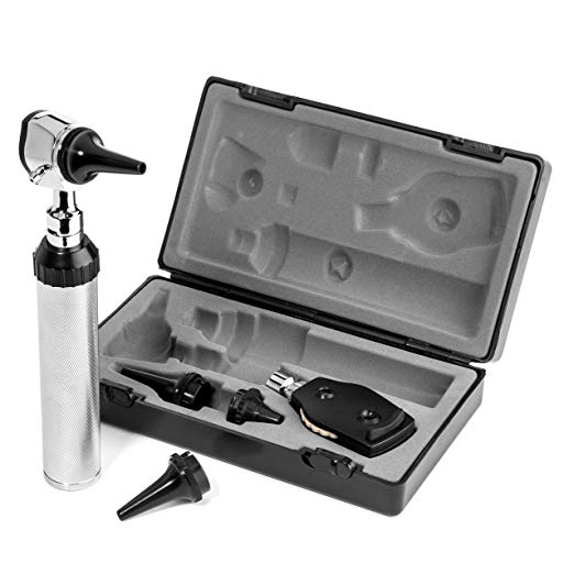

    School OTOSCOPE Kit
    Cost – around $100, depending on the vendor.
    Listed items:
    • Natural Hue LED Light source for an unmatched view into the ear.
    • Otoscope head utilizes a Medical grade GLASS lens with a 5x magnification and is attached on a swivel mount
    • Comes with three reusable speculas sized for pediatric, young adult, and adult use. Also a disposable specula adaptor which fits most standard disposable specula is provided
    • Requires two C-Cell batteries (not included) any brand will work
    • Handle utilizes a rheostat switch for gradual light
    Worth noting
    - Some LED lighted Otoscopes can have a noticeable blue tint when observing the eardrum, this may mask coloring at an early stage on an infection. Not good or bad, just something you should be aware of.
    - Variable light source – something I like, not vital, but a very nice option
    - Glass lens. The lens in an Otoscope is THE most important item in the device.
    - Replaceable C batteries. These size batteries provide very long service. DO NOT store batteries in the device.
    - Adapter allows use of disposable specula – very nice touch.
    NOTE - this specific kit comes with a coaxial Ophthalmoscope head. This is a separate device and is covered later.

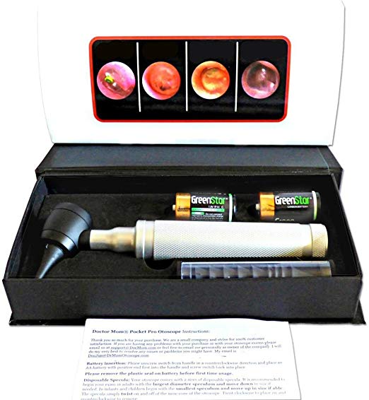

    Dr Mom brand 'home use' Otoscope
    Cost – around $40. This has a large glass lens and removable specula. Only comes with two sizes of specula. Does have full sized handle that uses C cells.
    The Dr Mom brand also sells lower cost devices – for about $15. These use AA batteries, have a smaller, lower power plastic lens. These may be suitable for 'home use' and do come with a pamphlet with color images of good/bad eardrums…
