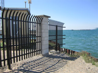

    I am in search of advice or input from people who have built a fence. I have been gifted a couple hundred feet of nice black metal fencing. The fencing is 4 ft in height. Due to my elk issue, the ideal fencing height in my area is 6 feet high. I am lacking 2 feet. I was thinking of putting the 4 feet on the top and then running a strand of electric wire on the bottom two feet, probably at one foot up. I heard that bears and Mt lions are deterred by electric fence, it will not 100% keep them out but it will discourage them.
    Anyone who has erected fencing, your input would be greatly appreciated. Pros/ Cons, issues you see with design.

    It is a coated black fence. Most I have spoke to say put the 4 feet on the bottom then string barb wire on top. I have tried that before and the elk reach through then get their horns tangled and they yank which loosens my posts.

    I would put the fence up high enough so they see the inconvenience and the wire low if it is Elk that cause the most trouble. otherwise they may try and jump and break the hot wire if it is on top... not aesthetically pleasing but it would function...
  5. kellory
    Ok, so the fence can not be used, itself, and an electric fence, and it will need to be separate electrically from the electrified section, so it does not short it out.
    You are talking about two separate fences mounted to the same poles, with no connection (electrically ) between fences? Sounds like it should work.
    Only time I've added electric to an existing fence, it was a full wood fence.
    (I've built a lot of fences, wood, or chainlink, but seldom mix styles of fencing. Hope it helps.

    I haven't had elk issues yet (knock on wood) but they are just down the road. We do get a lot of deer. Like you, most of the folks around here put up fencing that is 6 feet high, others will recommend 8 feet but anyone I have met with a 6 footer has never had problems. What a lot people do is they will get a standard 4 foot chain link and then extend it using steel pipe and heavy gauge wire, same as you use for horse corral. They lash the pipe to the fence post however they wish...stainless hose type steel clamps or whatever... It is the height of the fence that is the deterrent not the strength of the fence.
    I would definitely not put barbwire on top as either it is high enough that they won't try it or it isn't. All barbwire will do IMO is wound the animal. And, I don't see the sense in making it electric... Now, having said that I have not had elk - yet - but I would think they would react just like deer but maybe I am wrong.
    All the deer needs is to be able to see that it is high and will be difficult to get over. I didn't even use metal fencing on our garden. We made it 6 foot high out of this plastic type fencing, it really is quite thin and it doesn't rot, UV resistant and the deer see it and do not try to go through it or over it. Our stakes are 8 footers drove in 2 feet. It's cheap but works. I had 15 deer today over for lunch. I can post a photo if you want.
    I will probably put up a metal fence someday but first I want to be darn sure the wife is NOT going to be doing any more expansion on me because she has already said were increasing the size of the garden this year.
