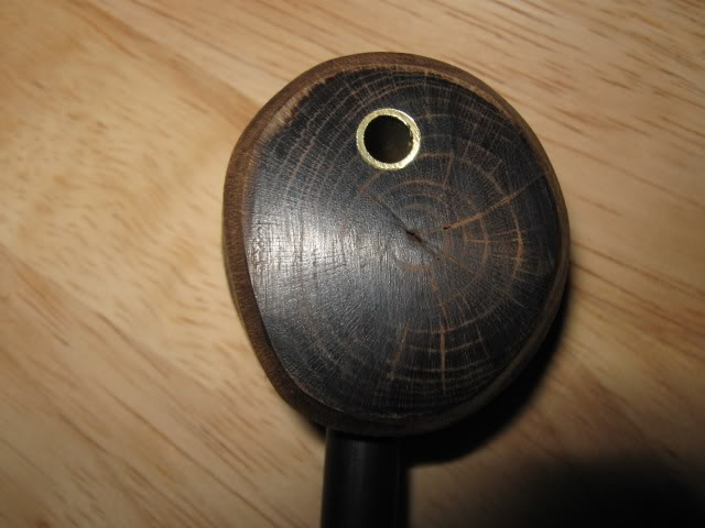

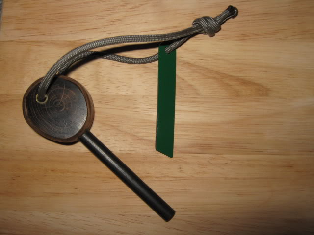

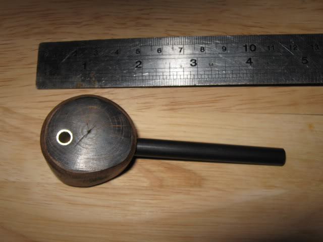

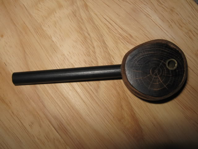

    I've just finished making a chunky Laburnum handle for a ferro rod blank.
    You have to be careful when using laburnum as its not good to get the dust into your lungs or eyes so I wore a face mask and goggles.
    It was very easy to make,I used a hand saw to cut it to size then shaped it on my bench sander.
    I drilled an 8mm hole as thats the diameter of the ferro rod,then glued it in place using epoxy resin.
    It has a 6mm brass lanyard tube and good quality para cord with a striker.

    Not really,I just do them for fun and when Ive bought ferro rods in the past they come with nasty plastic handles or you pay an arm and a leg to get a wood or antler one.
    My way of thinking is the handles are very easy to make,shape the wood and drill a couple of holes,a little glue and the jobs done.
    This is the main reason I posted this to get others to play about and make there own.
