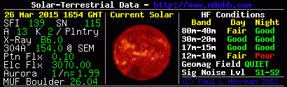

    Let's see if this works:
    There, that may not update but it's a banner that shows current solar activity, and the band conditions that result. Got it from HF Propagation and Solar-Terrestrial Data Website
