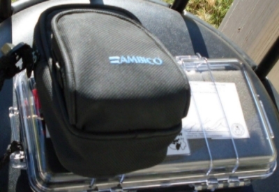

    Packed up, small case is all of the antenna components and two extra band modules.
    Opened. Everything needed to operate but the antenna & tuner.

    Pelcan 1060 carry case (waterproof) 15.125 oz. antenna carry case 3.75 oz
    Total carried onto airplane - call it 50 oz. all told. 3.125 pounds.
    Note – SOTA external tuner weighs less than most internal tuners. The carry case(s) were over 1/3 of the total 'system' weight. I could cut some weight by going with 4 x AA lithium cells for 14.8 VDC supply at a ~3 oz saving, but then would have the hassle if using commercial air transport. With the manual ant tuner, I'm kinda stuck with separate 30 and 40/20 meter wires. Other than finding lighter carry cases, I don't see how I can strip much more weight.

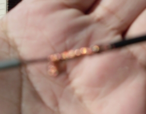

    When I set up an antenna, in this case, a an End Fed Half Wave, I put a splice in the antenna wire using a so-called Western Union wrap. I'm always careful where I string up the antenna, but just in case, this splice acts like a 'human fuse'. Which is to say, if someone wanders into the wire, it will 'break' before anyone gets hurt. Something everyone should think about unless you are able to always get your wires way up high.
    The SOTA tuner worked. I'm not done playing with it, but it is operational. Tuned the 20M EFHW fine business and also worked well using the same wire on 40 meters, so I've finally gotten the antenna parts sorted out. I have a second wire for 30 Meters and a stub if the setup requires a counterpoise.
    Pic of human fuse splice in antenna

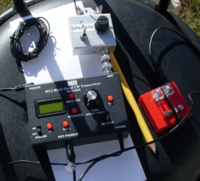

    Station set up and ready to go. The key is a Whiterook MK-32 Mini SideSwiper Cootie Key. Packs nicely, works well enough for travel or field ops. For fixed station, not so much. I may wind up with an all metal key, still looking at this part of the station.
    [​IMG].
    Yes that is a barstool. You operate where you want to, I'll operate where I want to... The arrival of the remains of Hurricane Patricia put an end to station ops almost as soon as I got started. Still, I did get some time on 20 M and snagged a K7, a KD5, and an N9 in Wisconsin along with an A8. All good copy with just a bit over 5 watts from my end. They did the heavy lifting, but it worked.
