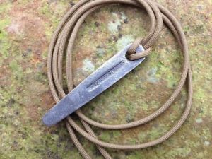

    I have a few different flint and steel fire starters. Not all are good in my opinion.
    This is my favorite. It sparks almost every time and has the wood handle so I can scrape some wood off to help start a fire plus it has the magnesium to help ignite things.
    This is a good flint and steel. Basic and dependable. Sparks easy, cheap no complaints. Fits in a pocket easily. Has the metal chain that you can clip onto the outside of your bag.
    This one is junk. I forgot where I bought it from but I cannot get a spark. I have practiced over and over and nothing. I have no clue why it will not work. I was thinking of taking some sand paper and rubbing it down. It makes no sense. Anyone had an issue of a fire starter not working?

    Some fire starters have a protective anti spark covering, maybe polyurethane. Sand paper is a good idea.

    I have several of those ferro rod and hacksaw blade striker fire starters. I find I get the best spark from the larger rods. Getting that coating off first is critical too.

    Do you mean I need a file to get off the protective coating? This fire starter is a good reason why one needs to know how to use something before you really need it. Tell me what you would recommend to get the coating off.
    Zimmy and Bishop like this.
  20. Seawolf1090
    I just scrape with the striker tool, until the coating is gone and it sparks well. Not a problem.
