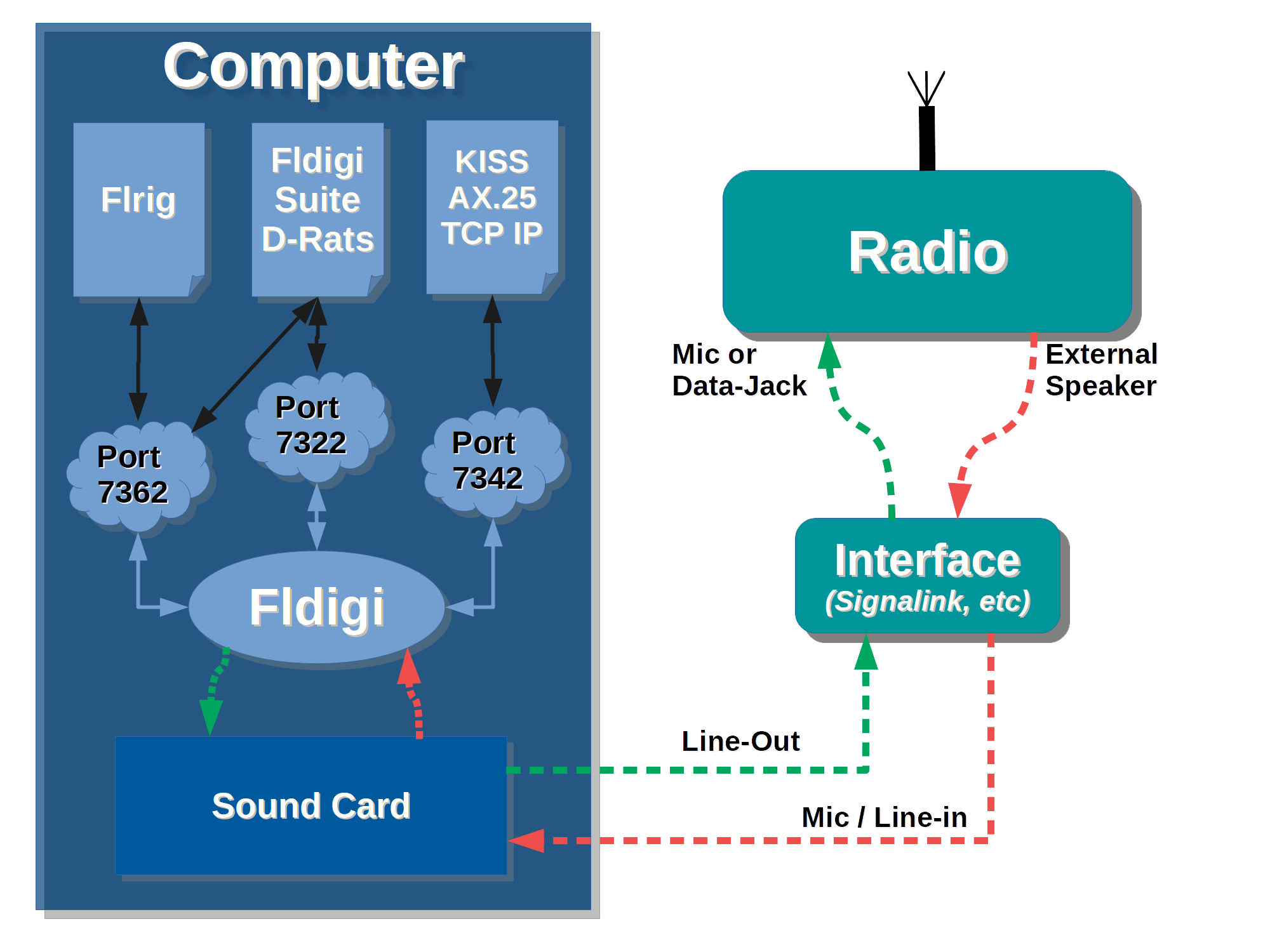

    digital modes require some kind of computer sound device and a way of getting that into and out of the radio. In it's simplest form then, you could have your laptop's microphone 'listen' to a shortwave radio's speaker and it will indeed function. Any kind of noise in the room will of course interfere. It's much better to have some extra circuitry to isolate the electrical grounds and so you usually end up with something like a SignaLink with an interface cable designed for your particular radio. The whole kit (new) is about $125. It can be done other ways, but this is the cheap/easy way to get started. The software on the PC is typically available for free download.
    NONE of this is part of CW. Just tune in and listen. Decoding is harder than sending.
