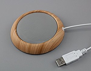

    The light bulb seems a little vulnerable to breakage, positioned where it is, you may wish to consider some way of protecting it from accidental damage.
    Another possibility as a heat source might be to use a USB cup warmer. A low voltage option that isn't likely to melt the thermal insulation.
