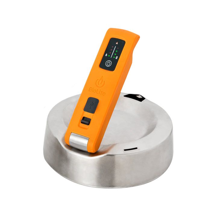

  9. Mindgrinder
    S'pose if u got a stove always burning you might as always have a pot of water charging somethin...
    BioLite KettleCharge - Mountain Equipment Co-op. Free Shipping Available
    • Powers most USB-chargeable devices, including tablets.
    • Made from stainless steel, aluminum, and high-temperature plastic
    • Includes an insulated USB extender to keep cords away from the heat.
    • USB power output of 10 Watts (5V, 2A).
    • Lithium iron phosphate battery with 1250mAh capacity.
    • 15 minutes of charge provides approximately 5 hours of talk time, 5 hours of video, or 20 hours of audio (output varies by strength of heat source).
    Power Practical PowerPot V - Mountain Equipment Co-op. Free Shipping Available
