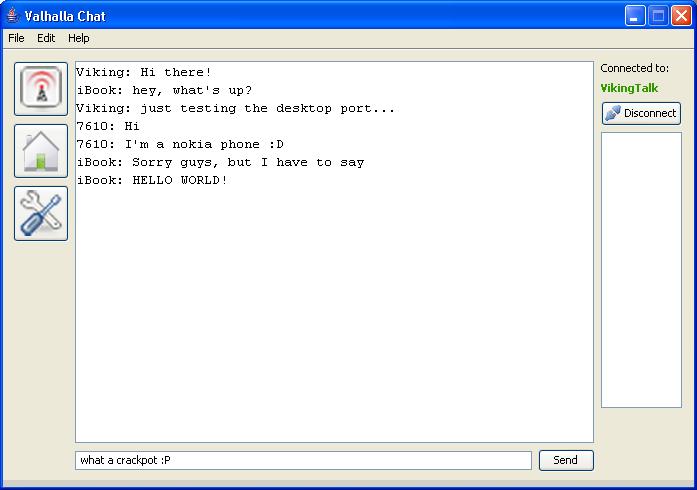

  9. melbo
    But IM requires a relay server between the chatters, no? XMPP IM requires a backend like ejabberd to 'relay' the chats to the users.
    So it would have to be strictly p2p communications which might be limited in application.
    The only thing I've ever seen done point to point was screen sharing (chatting in a txt editor) via VNC which might be a possibility.

  10. melbo
