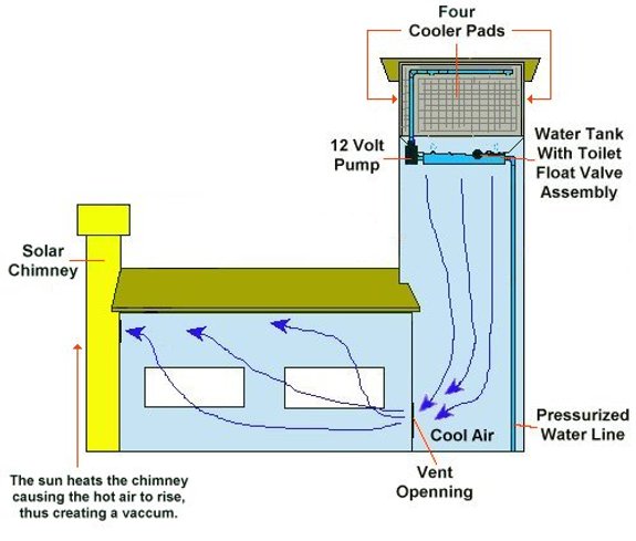

    in SoAz (hot with little humidity) these type designs are coming into the market place more and more. A small solar panel to run the pump, and cool air is easy to produce....
    I like the design, and wish it would work better around here. I just jump into the surf to cool off, with the added benefit of drowning any chiggers that are trying to eat me.
    I stayed in a home (California?) that that had a giant swamp cooler like that along an entire wall of the outside porch. Ruined the view, but it sure made it feel cooler on a hot day when the enormous whole house (attic) fan would kick on and exchange all the air in the house. :)

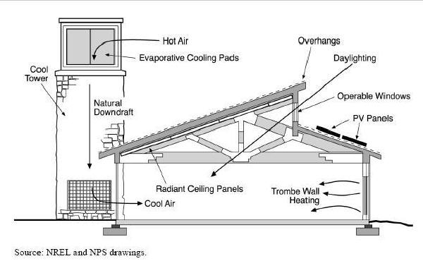

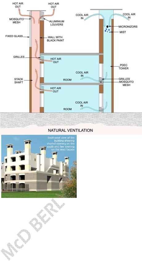

    The U of A (Go Wildcats) has been in the forefront of solar and cooling for a very long time. Given it's location in Tucson, it isn't surprising.
    http://ceac.arizona.edu/sites/defau...al_down-draft_evaporative_cooling_devices.pdf
    These can be built into anew buildings
    13 page
    lots of graphs and illustrations
    There are existing buildings that incorporate several low/no energy technologies for HVAC & lighting
    This is the Visitors center at Zion's Park, Utah.
    These are successful only in limited areas - this would never work in Alaska or any northern tier US States. Much of the Antebellum South would find only parts of value. So-called heat chimneys (Trombe walls) are often found in older homes as a way to help in moving air on hot days.
