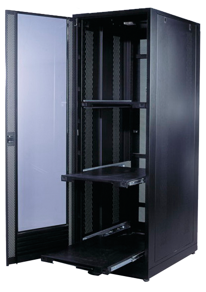

  9. Yard Dart
    I recycle these on a monthly basis.....
