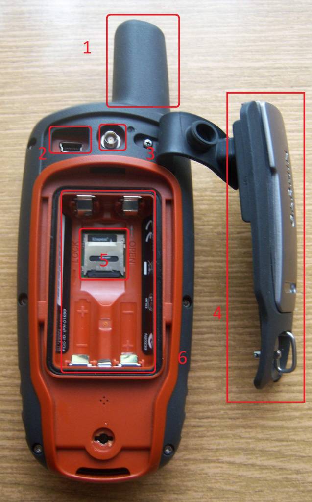

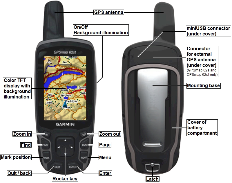

Look under cover on back for mini USB port (#2 in bottom pic). If I recall correctly, external power comes in through the same connector.
The USB port is there, but there's no indication that I've found that it can be used with an external power supply. The manual is here - http://static.garmincdn.com/pumac/GPSMAP62_OM_EN.pdf (The manual applies to all of the several forms of the 62 series, and appears that none of them have an external power connection.) Side issue, when I emailed Garmin, they didn't bother to reply.

Yeah, the manual isn't the greatest. Here is a video that shows a guy plugging the Vehicle Power Cable Part Number: 010-10851-11 into the mini USB port and the cig lighter plug into the socket in his vehicle to power it externally. Have fun. AT
