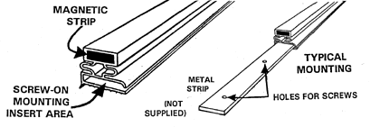

    Some doors close from spring loaded hinges, some suck tight with vacuum, and some have magnetic seals like these.[​IMG]

    To test for a magnetic seal, just grab a paperclip and see if it is drawn to the seal.

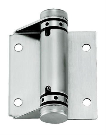

    It is very possible, that a spring loaded hinge could be screwed to the door and body of the freezer, and put more pressure on the seal if it is passive. [​IMG]

    Quite possible. Also quite possible that something got left out of the description. (That door closer idea isn't so bad.)
  17. kellory
    It came about from having kids. Send one to the freezer for something, and find it later with the door ajar and food soft. They SWEAR they closed the door, slammed it even (there's the problem).
    When any door is closed on a enclosed space, air pressure will not let it close completely, until the air has moved out of the way. The closer was replaced on the screen door due to the hold open clip wearing out, so this one got repurposed to pull the door tight. It will also hold the door open for loading.
