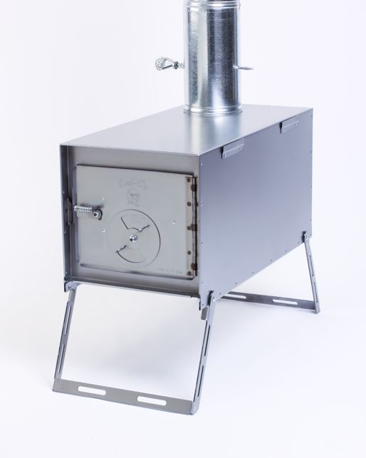

    I can not find this but....... what do you think about this one? it loks about the same and since it can be bought I would like some input. Im still wondering how to go about using it, but do know I can get lots of wood so this is a great option.
    Kni-Co Manufacturing Inc, Wood Burning Camp Stoves and Sheepherder Products
