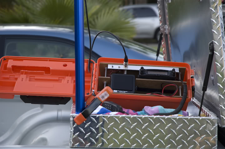

    I'm a big fan of Yaesu radios for VHF/UHF. I'd recommend a dual-band radio for greater flexibility. One that can do crossband repeating like the FT-8800 is even better. I have a couple of 8800s and love them. I wouldn't mind a couple more. I also have Alinco single and dual-band radios, and a couple of Icom and Yaesu 2-meter radios. All of these can be powered from a single gel cell battery. I have a solar charger to keep the batteries topped off in the field.
    I've built kits with a radio, battery, and antenna in a small ammo can to put in other vehicles. You can get small mag mounts that work great. Depending on how much you plan on transmitting I'd look at around a 17-20AH battery. Of course I do have a 10AH in my current go-box now and I can get all-day usage out of it.
    For those aghast at the thought of having a license there are ways to make it more difficult for folks to find out who you are but I'm sure we all have ways we can be tracked down. Sure, if shtf the FCC will have other things to worry about. However, buying radios to use when this happens is, imho, pointless. If you don't use your radio now how will you know how to use it when it matters the most? How will you know which bands to use? What will you do if things go wrong? If you use your radio now and you're unlicensed then you're breaking the law.
    Whether you're a prepper or not, if you have radios I'm a firm believer that you need to be able to improvise. We did a Macgyver drill at our last ARES meeting. Each time got a box with pieces and parts (radio sans antenna and battery pack, wire, AA batteries, electrical tape, etc.) The teams had to use all the parts to make a working radio and key up a local repeater. This is certainly something that could be required after a hurricane, tornado, or other natural disaster. Who knows what you'll have left that's in working order?
    So my point, while getting a bit off of the OT, is that it doesn't make much sense to me to buy radios and not use them (legally) until you need them.
