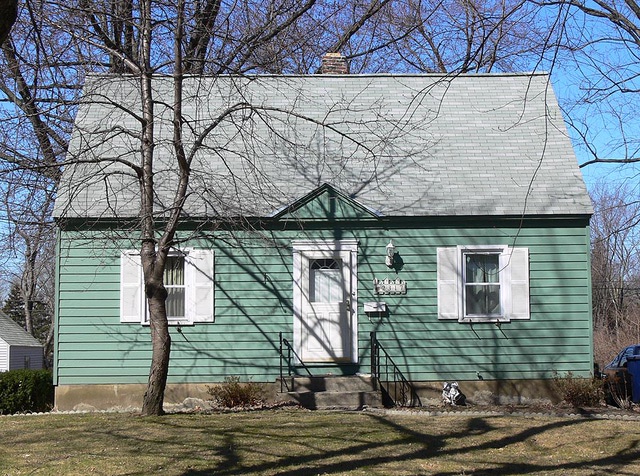

    [​IMG] this is a similar structure house. (Google pic) how would you do a Stealth antenna here. Flagpole would be about the same location as the tree.
  6. kellory
    I installed the roof, I have the ladders to install what I will, where I will. I just don't want it known that it is there.

  10. Tikka
    Tikka Monkey+++
    For VHF or UHF just climb the tree, place antenna, drop the coax to the ground behind the trunk and use Belden mil spec so it can be buried.
    As their wave length is short; you don't have to climb very high.
  11. kellory
    How high? And why not do that inside the flagpole?

  15. Tikka
    Tikka Monkey+++
    As high as you feel safe climbing and are willing to buy coax to reach your transmitter. As VHF and UHF attenuates a lot more than HF; buy the good low loss stuff. Belden is more expensive; however, it survives being buried.
