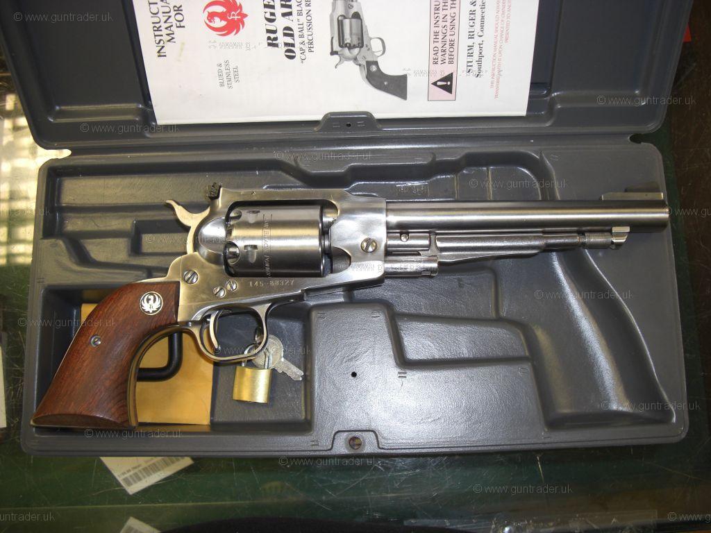

    So, I got my self a new Ruger Old Army ( Damn things keep multiplying like those Damn Colts I cant seem to pass by) and I am in the process of modifying this bad boy to fill a need for a POWERFUL side arm I can carry during the Muzzle Loading seasons where I am NOT ALLOWED to carry a centerfire/ smokeless pistol of any kind!
    So, the first step was to shoot it and see how she runs, second was to run a ladder test with all the different powders I can find/make, and all the .44 cal bullets I can find/mold to find where it runs best.
    Third step is to boost it HARD! Employing the services and expertise of our local legendary smith, We are looking to deepen the cylinder bores extra deep ( as measured, looks like we can gain about 7 or maybe 8 grains capacity) which puts this solidly into .44 mag/.45 Colt territory, which should be just enough me thinks! What's always impressed me with these Rugers is the brute strength built into them, and the accuracy is far better then any B.P. pistol I have ever run across, including the much vaunted Colt Dragoon ( Real One) and the potential of boosting one is too tempting to not do it!
    Pedersoli pistols of the 1858 Remington pattern can usually be deepened at least 8 grains, and it looks like the Ruger could go even deeper based on my crude measurements, BUT, I'm running hollow base conicals, so things get VERY interesting there! Will update once we deepen the cylinder and get to testing it out!

    Obviously, I guess, do NOT intrude into the nipple threads while "drilling" the chambers deeper.

    NOPE! Trying to determine the max depth I can reach and still have a safe margin!

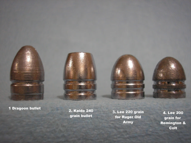

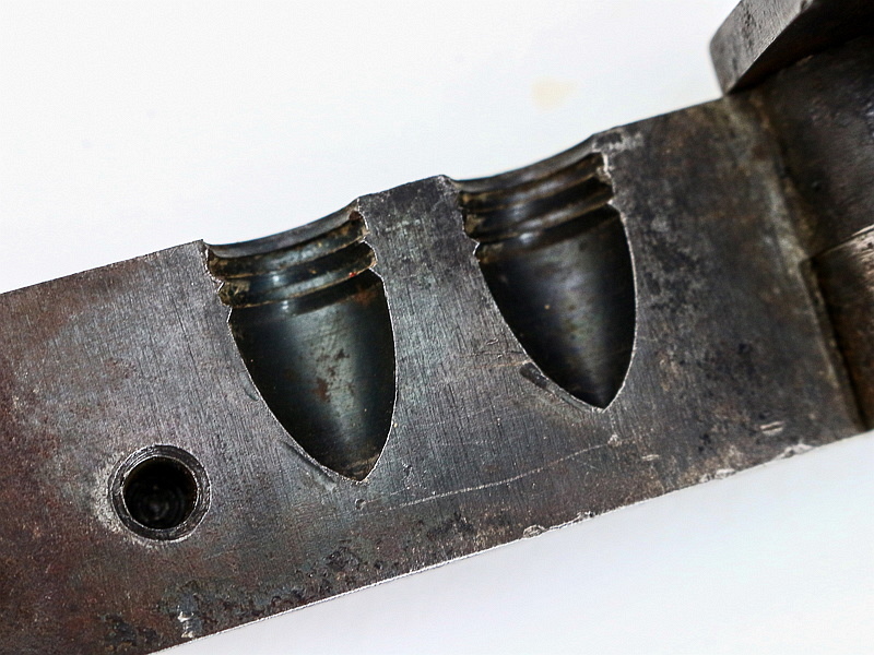

    If the plan is to hunt with the revolver I'd like to throw out an alternative that might make it a better game getter without altering the cylinder at all. You're using a hollow base conical mold. This is a basically round nosed bullet. Might expand some on impact, but will likely make a wound about the same diameter as the bullet. Now you take a $20 Lee aluminum mold and straighten up the sides a bit above the top grease groove and you have a bullet with a nice fat meplat that will have a more devastating impact on game. Bullet weight increases, so recoil will likely increase, as velocity decreases slightly. This is a dance that you'll have to test on the intended target, but I can tell you that I've eaten more deer whacked with big, flat, slow moving bullets than fast rounded or pointed ones. Kinda like getting hit with a telephone pole.

    Actually, I'm using a .50 Cal front stuffer for the hunt, and the Ruger is intended for Anti Bear, so I need maximum penetration over all else, and that requires not only velocity but bullet mass! I'm using a custom mold based on the original Colt #13 270 gr Rifle bullet that I have hollowed out the base on deeper then the Colt mold normally would! I would use the Colt mold if it had more gas checks and didn't have the swedging taper, thus the custom mold with deeper base cutter screw, and if needed, hollow point cutter/reamer with Dumb Dumb tool for if/when that's needed!
