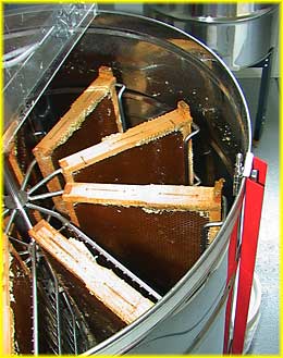

    There are two fundamental types of centrifugal extractors.
    1. The conventional type holds the frames with one side facing outward, it is spun and then the frame is flipped around and the other side is extracted. These are smaller models and generally extract two or four frames at a time.

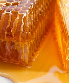

    2. A radial extractor holds the frames much like the spokes on a bicycle wheel with the top of the frame facing outward towards the side of the extractor tank. As the frames are spun, generally at higher speeds, the honey is removed from both sides of the frame simultaneously. This only works because of the downward slope of the cells towards the center of the comb. If you cut a 5 inch square of comb from the hive and then look at the end, the comb will have a slight downward slope to the center of the comb on each side. This isn't the best picture but shows it a bit:
    Here is a radial extractor:
    So, it seem the honey flow thingy is relying upon the same cell slope.

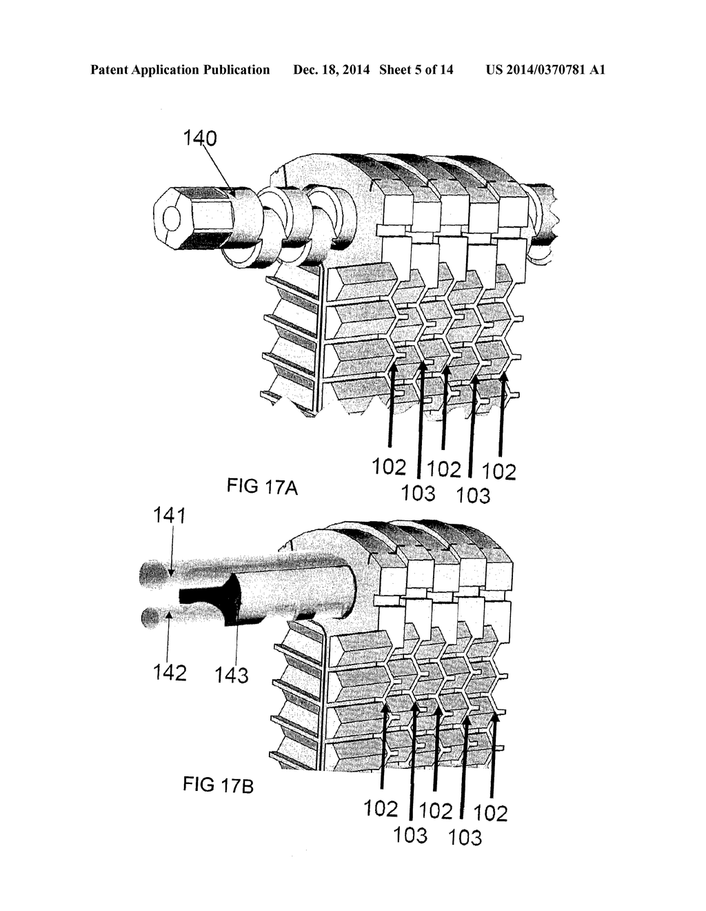

    Here's a copy of their patent application. United States Application US20140370781 Basically, the cells of the comb are broken up in to vertical strips so that they can be moved up and down relative to each other and grind the honey cells.
    Apiculture (this is a PDF download link.)

    Ahh... Bingo, that's how they may deal with the cell cap too. When this thing is cranked, it will break any additional wax that extends further out and quite likely break/split the cap and it's seal as well. Then the bees have to clean up and repair the cell extension and the cap will be chewed away in that process. This makes sense. I get it and it could work.
